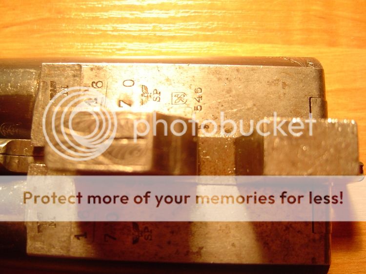

No worries but could you pleasure us with a few images of the marks to see if possibly Triebel was a Röchling-Sonderstahl(Special Steel) vendor also. For now it is tough to pin down the date for Röchling-Sonderstahl but I would guess circa WWI and a date code might help narrow the date.
Posts: 12,850
Posts: 12,850
Not exactly the Röchling Sonder Steel mark I was looking for but Röchling Sonderstahl Marke Furodit
Chr. Friedr. Triebel sideplated boxlock proofed May 1946 with Röchling Sonderstahl tube steel.
