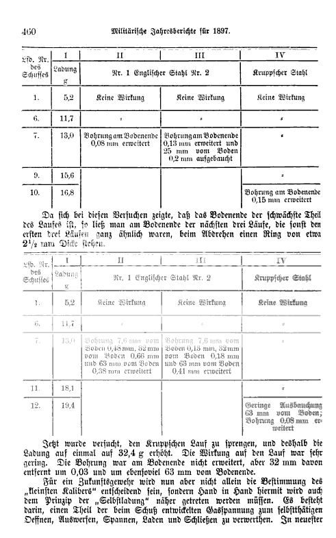

As a side-note, on March 6th, 1897 "The Field, The Country Gentleman's Newspaper" either performed a test or had a test performed on 3 scattergun tubes, 2 of English variety and 1 delivered by Krupp(says Spezial Stahl but no 3 Ringe), although I have serious reservations they actual made it but subbed the effort to Sauer. Tubes were 12 bore being 18.6 mm in diameter & having a wall thickness of 2.54mm. This is one of the very few instances where the concern Krupp and a sporting weapons tube are associated. Krupp began development of the Spezial Gewehr Lauf Stahl in 1893 and filed a trademark in 1896, I believe.

The 1897 English vs. Krupp tube steel test results:
A translation may prove insightful.
