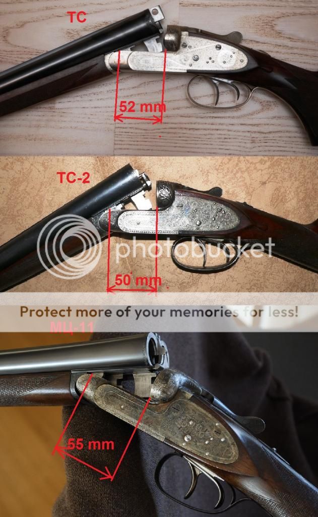

A Russian collector supplied me with this tid-bit of info:
After the WWII a gun making school was established in Tula.
The 1st shotgun was called TS (TC-1). It was a copy of a Lebeau sporting weapon(as HD notes).
The 2nd was called TS-2 (TC-2) and was a copy of Purdey self-opener(assisted opener) and was made by TCKIB (-Sporting and Hunting Guns Central Research and Design Bureau, Tula).
It was weak as sporting shotgun . The MC-11 (MU-11) was made on the basis of TS-2 .
The difference is reinforced bar and longer flat. The MC-11 has two other top lever actions: Greener cross bolt or Purdey latch.
The shotgun: MC-11 (MU;-11); Modifications: MU11-1, MU11-2, MU11-3, MU11-4(note the Us are as close to the actual character)
Destination: sporting
Caliber: 12 Chamber: 70 mm
Barrel length: 750 mm (trap), 675 mm (skeet) ; Steel: 50A (low-carbon, Izhevsk prod. - this is the 4 Ringe that replaced Krupp's 3 Ringe post WWII in Germany) -
http://www.doublegunshop.com/forums/ubbt...true#Post172682
Weight: 3.5 - 3.7 kg
Action: self-opener (Beesley - Purdey)
Ejectors: no
The first was made in 1951 (actioner Vladimir Tetiorkin -)
Produced only 613 shotguns (from 1951 to 1955 - 328)
It was the main gift of Nikita Khrushchev (with very good finishing and case color hardening)

I'd say so; maybe term it Beesley action type/variant or Purdey action type or pseudo Beesley/Purdey action. I have serious reservations that they sourced the actions from Britain.
