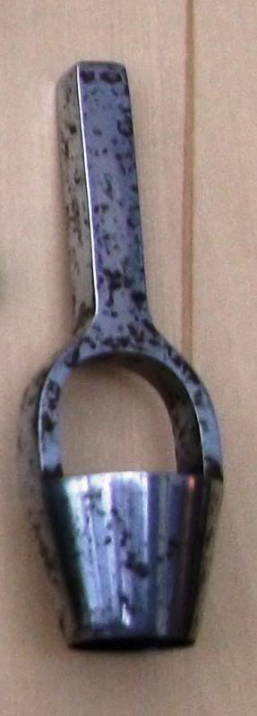

Hi Bob1900
Have a hunt for one of these wad cutters the one in the picture is for making 12 bore wads it was probably part of the tools that where included in a cased shotgun.

Originally Posted By: damascus
Hi Bob1900
Similar punches of various sizes can be found for leather work and other similar crafts.

Yeah, a punch is the way to gp.

The punch would have to be very , very sharp to cut a wine cork. I've tried to trim a wine cork with a knife to replace it into a partially filled bottle, and the cork does not cut evenly or easily.
