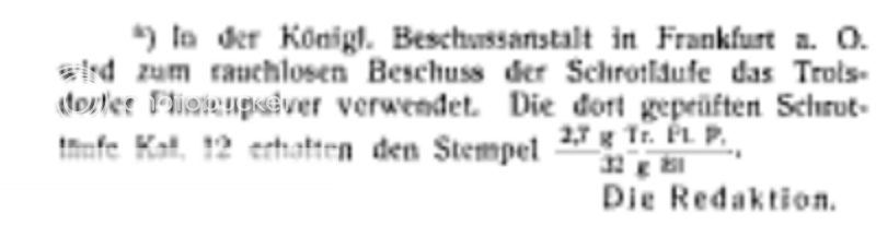

It is the voluntary stamp on the sides of the tube. Captain Edward Schultze devised the powder: http://books.google.com/books?id=scFMAAA...der&f=falseService load would be the typical/average central-fire cartridge loading.  Kind Regards, Raimey rse

You are correct Ford, but I have not seen another reference for the 1893 addition for semi-smokeless proof for the scattergun voluntary proof. Not sure the pressure would approach 4k atm but the stamp type is the same. Proof load can be 2 or 3 times the service load. So 2 times service/duty load = proof load depending on pass but the multiplier is not linear across the load. Say the powder charge will be tripled while the shot load will be double, etc.

Again Ford, you are correct as I grabbed the wrong paragraph:  Flintenläuf - Reichsgesetzblatt v. 23. Juli 1893  Troisdorfer Flintenpulver by the Frankfurt on the Oder proof facility Kind Regards, Raimey rse
