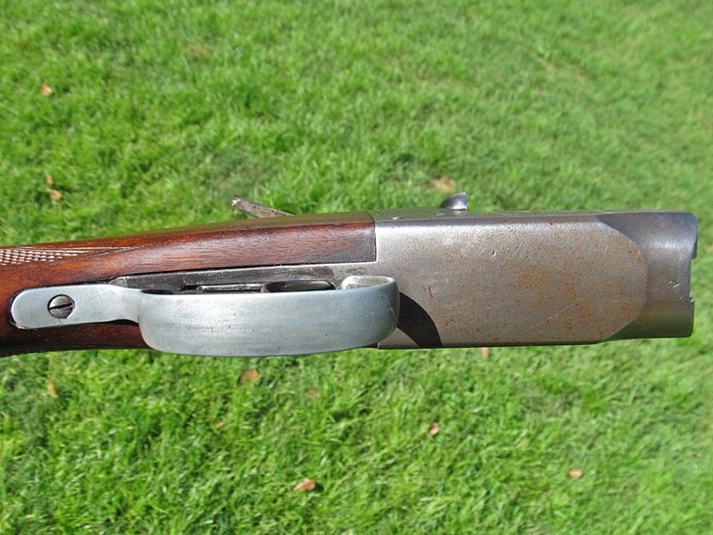

I find it interesting that the lumps appear to be laminate steel, i.e., like an old transformer body. Do you think that could actually the case or am I looking at it wrong?

While I may be wrong, and often am,the gun doesn't seem to be engraved, to me.To my eye, it seems more like acid etching.

I think you're right,,It looks like an etched pattern of one type or another and not an engraved one.
Stevens (Savage) used etched 'engraving' on the gussied up 311 made as the Fox BSE and BST models,,some small amt's of scroll and game birds on the frame IIRC.
If the gun(s) were made in the R&D Dep't for testing and show 'n tell to the bosses,,they many times didn't have serial numbers stamped on them even if regular production did.
Missing a date code on the recv'r wouldn't be uncommon either. All sorts of strange configurations got put together in the different factory Research & Pocket Protector Dept's.
That goes for any business I'd guess.
Sometimes those one-of's surface outside the factorys when the shelves are cleared. Serial numbers are sometimes added at that time if necessary. Prior to Dec/68,,they were not on a shotguns.
Just my thoughts.

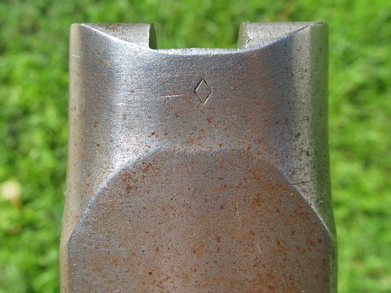

Mr. Newbern, the only thing on the bottom of the receiver is this small diamond.

Hmmm, either John Mann must have been correct about these being
pre-production prototypes or they may have been built before 1948 when the date code was adopted for all guns leaving the Stevens/Savage factory. I've never seen others like them. I think Mr. Snipe may have some very rare and maybe valuable guns!...Geo
