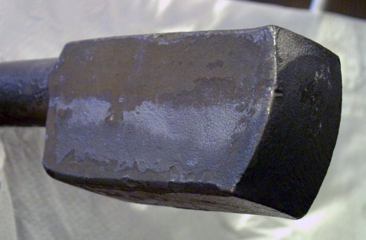

Shotgun and rifle barrels start from this. They're drilled, bored, rifled (if a rifle) and contoured externally before being joined and ribbed.

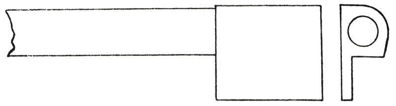

This is the breech end. The extra material projecting below the "tube" will become the barrel lumps.

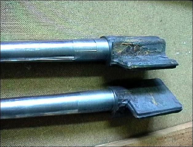

The second photo shows the tube portion in a rough turned state.
