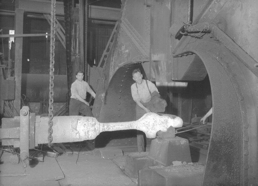

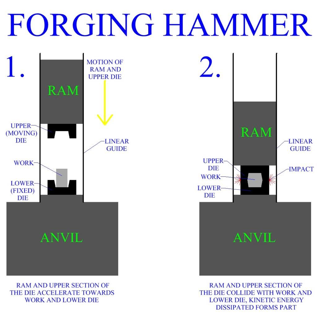

You seem to be confused. ALL forging involves a "hammer" (of some sort) which is used to work the hot, soft metal into a given shape. Not all forging involves a hand-held hammer (unless we're talking about farriers). I know that Ithaca's cute little stamp shows a hammer and anvil but I guarantee that neither of those tools was used in the making of their barrels.
Here are a couple of photos of hammer forges.
