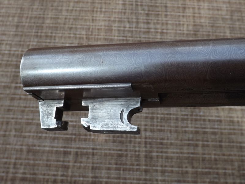

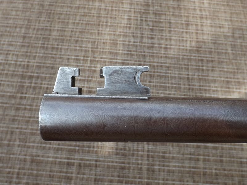

I have posted two photographs taken of put back on the face repairs to a couple of guns in my collection, I am assuming both repairs where undertaken in the eighteen hundreds. Both guns are Jones under leaver with Damascus barrels though this is really of no consequence to what I want to say.
In the first pair of photograph this type of repair back then was considered respectable and a normal every day working repair. But today by our standards we could judge it as incredibly poor standard of a big hammer repair.

The first gun with the half-moon punch marks on the hook has not been materially changed in any way other than aesthetically so the person who did the work did not leave the gun in a worse condition than he was given it.

My point in all of this is to restore the guns in working condition today. The gun with the hook adjusted with the punch would need the hook built up by whatever method and putting back on face.
