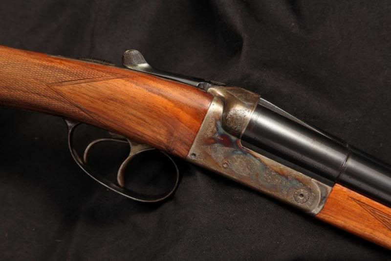

There are a few Ideal aficionados on the board, and I thought I'd get your input: It would appear that some later (post war) Ideals had monoblock barrels, quite a departure from the predominate demi, even on the lowest grades. Looks pretty clear in this photo:
The engraving on the barrels where the joint would be is of course the most obvious clue, another the break in the "plume." As Post Oak often says, "just when you think you know Ideals..."

There were two parts to this.
There was a "Robust-Ideal" low cost model first (in the 30s IIRC) and then the monoblock construction of the Robust was generalized in the 70s I believe.
I don't have my Mournetas handy, but it is well described in it.
Another option would be that the gun would have had issues along the way (such as being buried during WWII) and somebody sleeved it.
More info on the model would help.
I don't think that the "single digit grade" Ideals would ever have that "feature" from the factory.

Just having lunch right now on a break from house painting. Will check Mournetas tonight and see what I can find.
I think WC is on the right track.

OK, I am familiar with the stepped barrel, monoblock Robust.
Here's another one, represented by the seller as "like new." This ain't no Robust:

Mike, that's a model 375, made between 1975 and 1984. So extremely late in the production run. I'm looking through the Ideal book, practicing my French and seeing if I can find a date indicating when Manufrance adopted Pieper's barrel construction method for Ideals.

That's a late production gun, victim of cost cutting measures...
The 375 was one of the highest grade towards the end IIRC.

If it is in Mournetas' book on Ideals, I can't find it.
Would be interesting to know the model number of the gun you posted that is not in the ad. My guess would be that it too is a 375, supporting WC's contention that the use of mono block barrels is a result of cost cutting measures late in the history of Manufrance, as the enterprise was failing and while demand for SxS was at an all time low.

Ideal barrels are dovetailed and cross pinned, the genuine Demibloc system as invented by Henri Pieper.
Robust Barrels are monobloc, with the barrels inserted and fretted into the monobloc (cannons en frette) ie held by friction as well as solder.
ROBUST_IDEAL is a kind of hybrid between the Robust and the Ideal, having monobloc barrels, but not the "T" top extension. The top extension is from the Robust, flat with a flat bite.
The stepped monobloc was abandoned in later production in the Robust in favor of faired barrels.
The Ideal in the late catalogs, just before 1982, is shown in two models, the Deluxe and Prestige with monobloc barrels, though I have never seen one yet. Even though I have seen and handled hundreds of them I have yet to see two identical Ideals or any with monobloc barrels. The custom capacity of the workshop must have been staggering.
