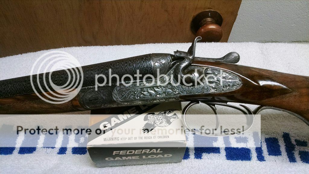

Looks to be pre-WWI but the marks will narrow the scope. Looks to be a Modell V or a spruced up Modell II?

That you put it circa 1888 - 1889.

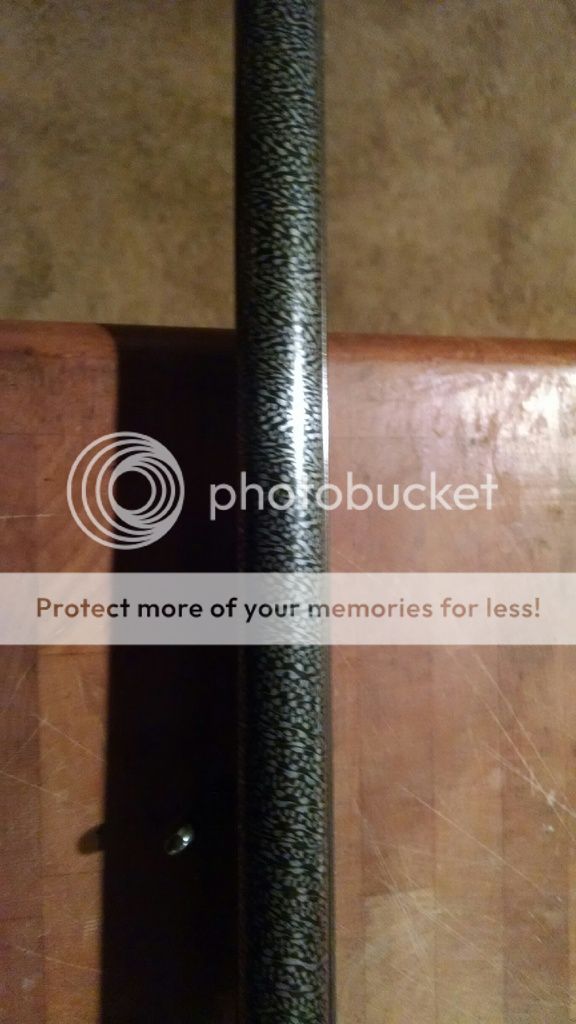

I'm curious if there are any marks on the underside of the tubes forward of the flats & aft of the forend hanger? Like HUF, etc.?

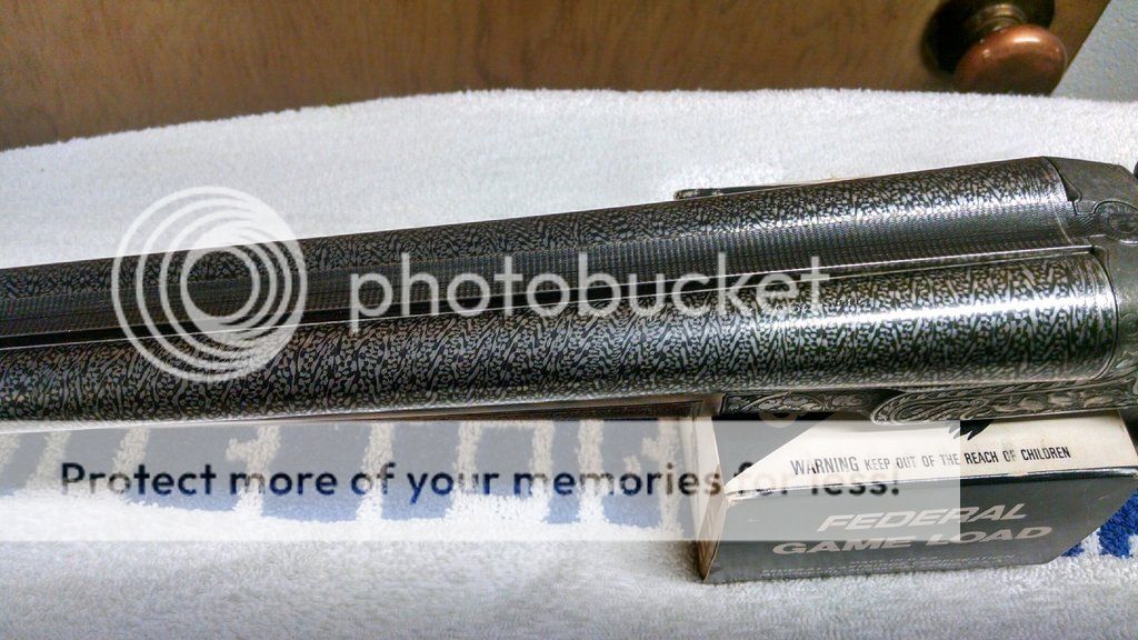

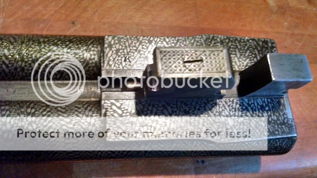

Yes; several marks on both barrels. They are barely visible, and I have gone to the internet to "German Proof Marks" attempting to see if any of them possibly match. (Without much luck)
"CAL" is clear, but then.....I can't read anything after that.
There appears to be a stamp of a man standing, but not really clear. There are Two "Crowns" on the flats, side by side, one larger than the other.
There is a mark on both which says "SO" Also, on the between the barrels bottom rib, there is a "S" which looks like a Sauer "S" on "modern" guns.

CAl 181(mm) would have been one stamp. The 2 Crowns denote quality(high) & shooting performance(pattern tested).

Sauer Hammergun with 182 S Bern 115 on each tube
Large & Small Crowns on flats & water table
Sam, your marks should resemble some of the above.

I see the SO on the tubes and some Script L? adjacent to a Script H and some numbers. I'll have to smoke it over a bit closer.
