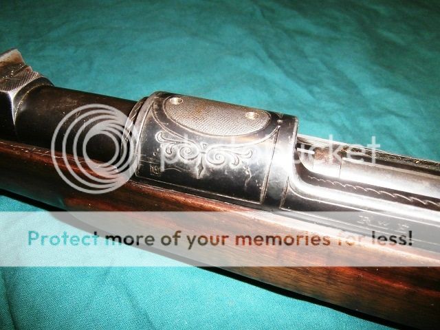

OK, here is my $0.02 worth, The "curious cross hatch pattern" on the bottom of the barrel seems to me to be Vise jaw imprints.The unusual milling cut on top of the barrel, seems to be to remove the opposite vise jaw imprint. There are also milling cuts on the sides of the barrel, which may be there to remove another set of vise jaw imprints. The eagle mark on the top of the barrel, seems to be a Bundesadler, which would be post WW2, after the Germans regained control of their country. This seems to be a rifle put together after the war, using available components. This, itself, would not be enough to make me afraid to shoot it.

I have a Krag with some marks just like it.

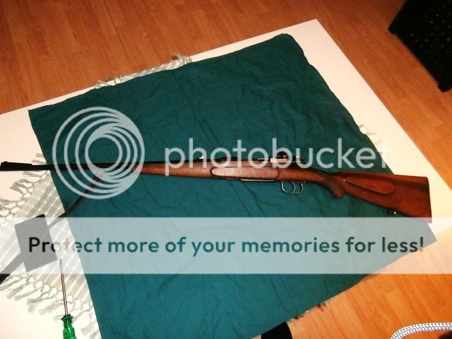

Below are some images of a RWE sporter from a Moose hunter in Sweden.

Very similar to a 98A sporter I own marked DAS.
Engraving is nicer on yours.

I noted the rather "meaty" knurling on the bolt knob (grasp) which means this was possibly made for a hunter in Countries where cold weather hunting is the norm- much easier to grasp when wearing a glove or a mitten on the trigger hand, I should think. I also agree with the vise marks- I have beaucoup vise-grips in my tool boxes, they all have straight across cut jaws, not at a diagonal--From the imprints, I surmise the barrel receiver group was not through hardened?? Any thoughts on this? Fox!!
