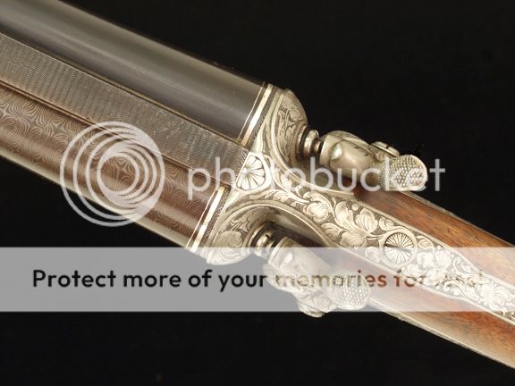

Helsley's adorned Immanuel Meffert w/ pattern welded tube(left) & steel(right).
