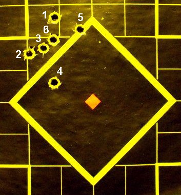

Here is the results from the range today.
1 & 2 are old 220g Speer RN bullets .320 dia
3 & 4 are new 220g Speer RN bullets .321 dia
5 & 6 are new 220g Hawk RN bullets .318 dia
All velocities were 1900 fps ave
I don't think I'll do any swaging down - the .321 bullets seem to work just fine and I have hundreds more than I'll ever shoot with this rifle.
I consider this composite group of under 2" to be very acceptable hunting accuracy given the 2x scope and the age of the scope and rifle and the little-bit of wiggle in the scope mounting system.

buckstix,
I agree the composite group is acceptable, and I would expect an improvement if only one bullet were used. If it were mine, I would load some with the bullet I had the most of, and go hunting.

Hello Der Ami,
Thanks for the reply.
That is exactly what I intend to do. I will load the Speer bullets because I have plenty of those. I intend to test these at 200 yards in the next few days to see how they group.
