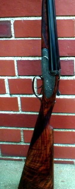

What gun is that ? Looking at the slim lines....I 'd guess she was built as a light weight ?
Better take good care of her...there's not much room for cleanup.

The arcaded fences 'sorta point toward Woodward....not known as a builder of lightweights, usually.
