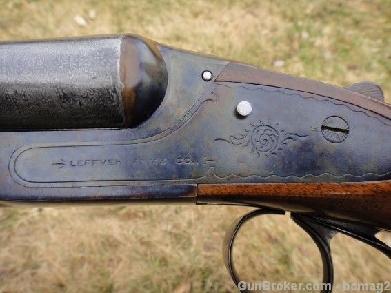

The barrels are "Washington" which is commonly found on F
& H grade Lefevers
In the interests of exactitude, Washington pattern Damascus is not commonly found on H grade Lefevers. I've never seen any. Virtually all have either Twist or fluid steel tubes.

HE grade with washington pattern damascus:
Its the only one I've ever seen...Geo
