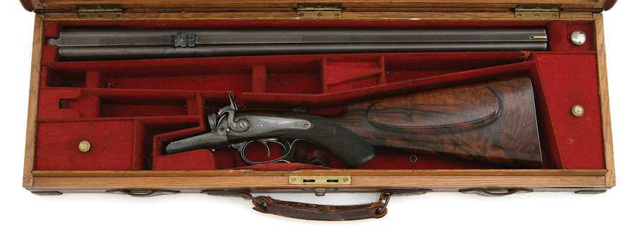

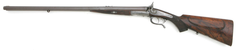

Yes indeed to both propositions. (1) The original "Automatic" was a self-cocking hammer gun; and (2) I have a virtual collection that includes one such Automatic hammer gun. This one is a rifle - a .577-500 BPE.
Again, I don't own this rifle and don't know who does own it. I scarfed the photos off the internet for my virtual collection.
