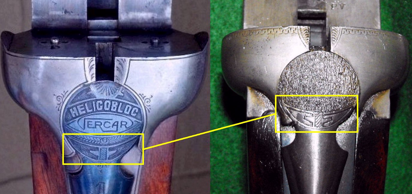

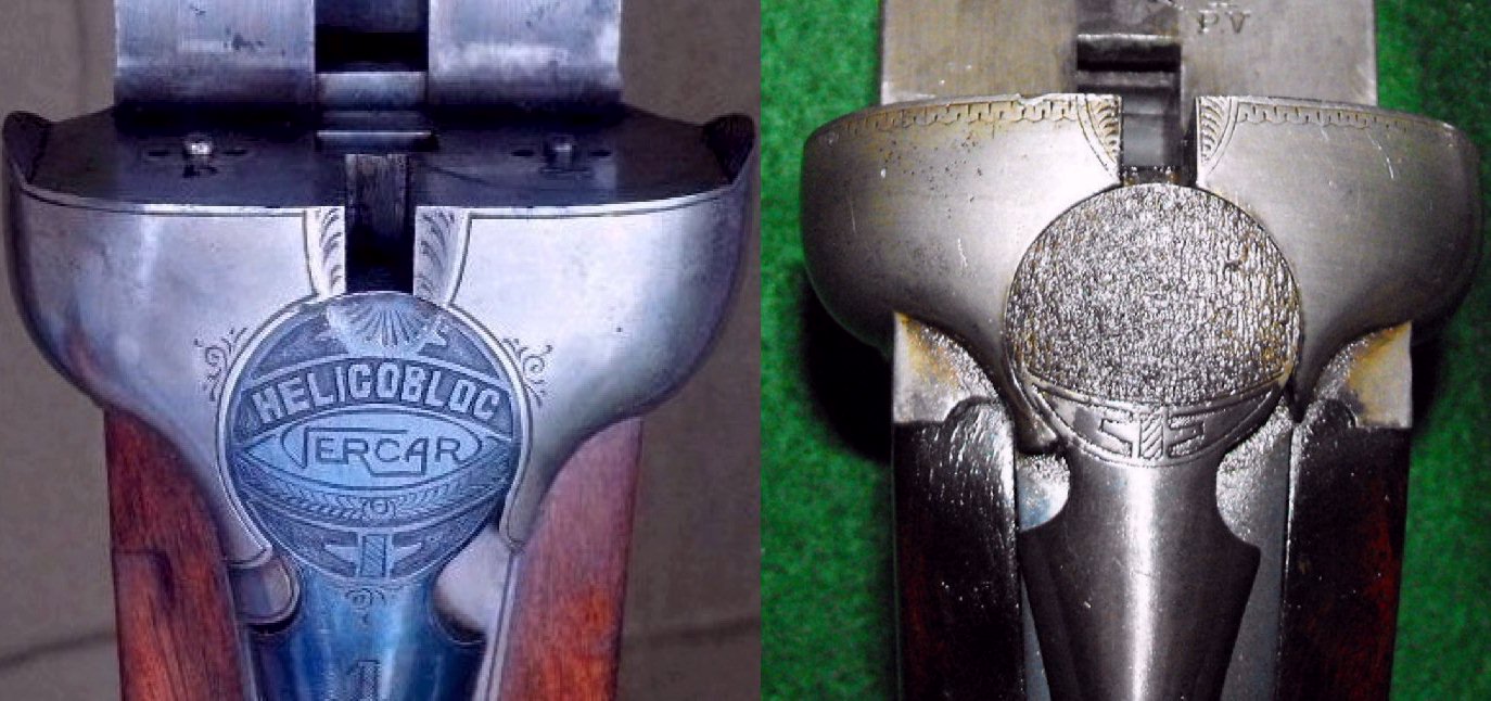

I see the "stop". My rifle does not have this. However, it looks like the lever was a Helicobloc lever that has the name "stippled-over" but they left the pattern at the bottom untouched.

All is very interesting & I continue to hold that it is an in-house V-C product. I don't seem to recall having seen that much "peening" on the toplever? I'll have to look.....
Cheers,
Hello ellenbr
Thanks for the reply.
If you find something about the top lever, please let me know.
