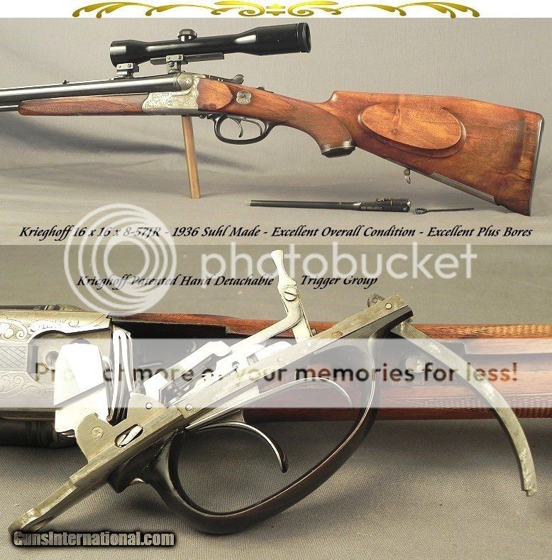

Greener safety on the left & selector atop. Blitz Action Sempert & Kreighoff all in-house Krieghoff offering. I do wonder if Kriehoff was the tube source for Roechling Elektro tubes. Then who might have been rolling the rough tubes?

I wonder if the "S HS" stamps denotes it might be 0.323"?? I would slug the bore......

If it is actually a 12ga it would be less common than having 16ga barrels. I don't believe that the barrel selector on that model cocks the rifle barrel, it only selects the barrel, unless there is a larger knob behind the selector shown.
Caliber is most likely 8x57R shooting .318 bullets. Most of the .323 diameter 8x57R are in post war drillings.
It looks like the date might be 11/35 (Nov. 1935).
Look for a 12, 12/70, 12/65, 16, 16/65 or 16/70 I don't know the dates when they started designating chamber length. If there is only a 12 o 16 in a circle or diamond they are 65mm (2 1/2") chambers. It should be on the barrel flats which aren't shown.
I admit I'm not an authority on drillings but a love to hunt with them and have three and am seriously looking at number four if I can get the gun fund back up where it is needed.
Welcome to the addictive world of drillings.

Originally Posted By: RedofTx
Who is the guy's name on the right barrel?
>>Robert Hübner was a native of Zella-Mehlis(probably Mehlis) but hung out his gunmaking shingle in Darmstadt, possibly circa WWI. He was a master gunsmith.<<
The left barrel says 'Sempert Krieghoff Suhl' for the bad pics.
>>Sempert & Krieghoff was the original concern founded by Heinrich's father.<<

Tomorrow I will go back with my Skeet's bore gauge to measure bore diameter. I will verify chamber length as well. But my Manson wall thickness gauge is permanently mounted on the wall. Any other pics that might help anyone?
Thank you all so much for your help.
This is why I read this bbs.
redoftx.
Typed 4/19 - 9:45amCST :
The drilling shotgun bores are 16, not 12. He had it listed as 12.
Right bore - 2 9/16 chamber; .680 bore; 2" of choke taper and .643 at muzzle.
Left bore - 2 9/16 chamber; .682 bore; 2" of choke taper and .645 at muzzle.
BBL length - 23 1/2" or 60cm
It is engraved Krieghoff Trumpf (if I spelled it correctly) under the receiver ahead of trigger guard.

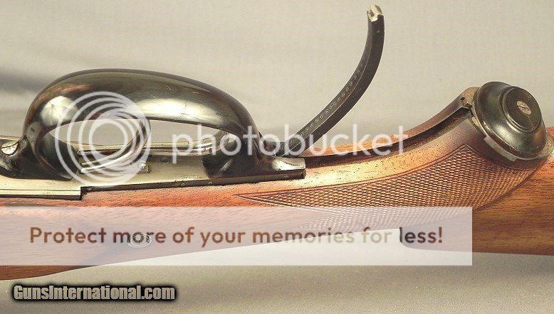

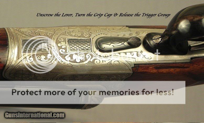

https://www.gunsinternational.com/guns-f...un_id=101089834
A similar S&K Blitz Action but w/ a drop-lock triggerplate
