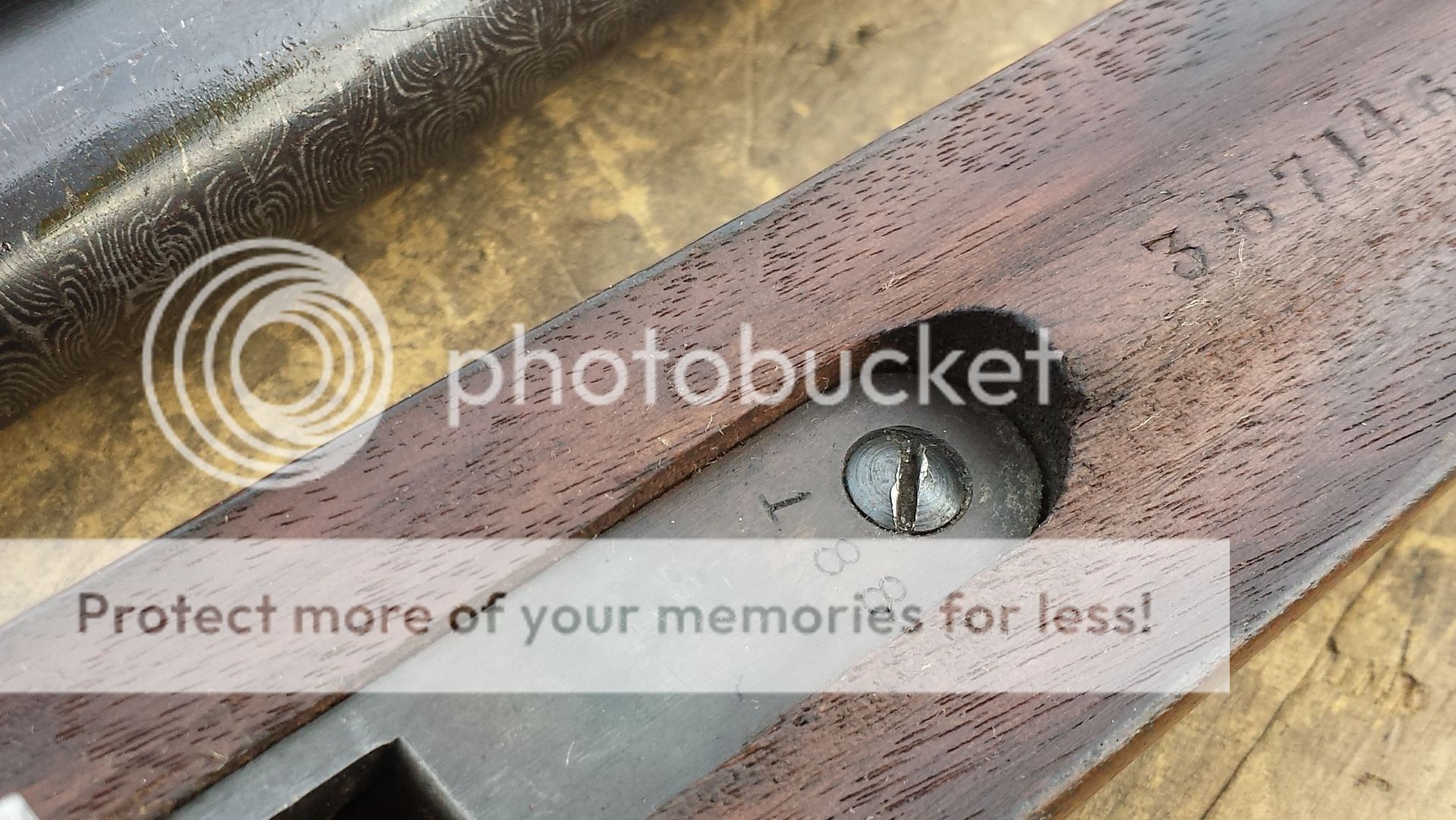

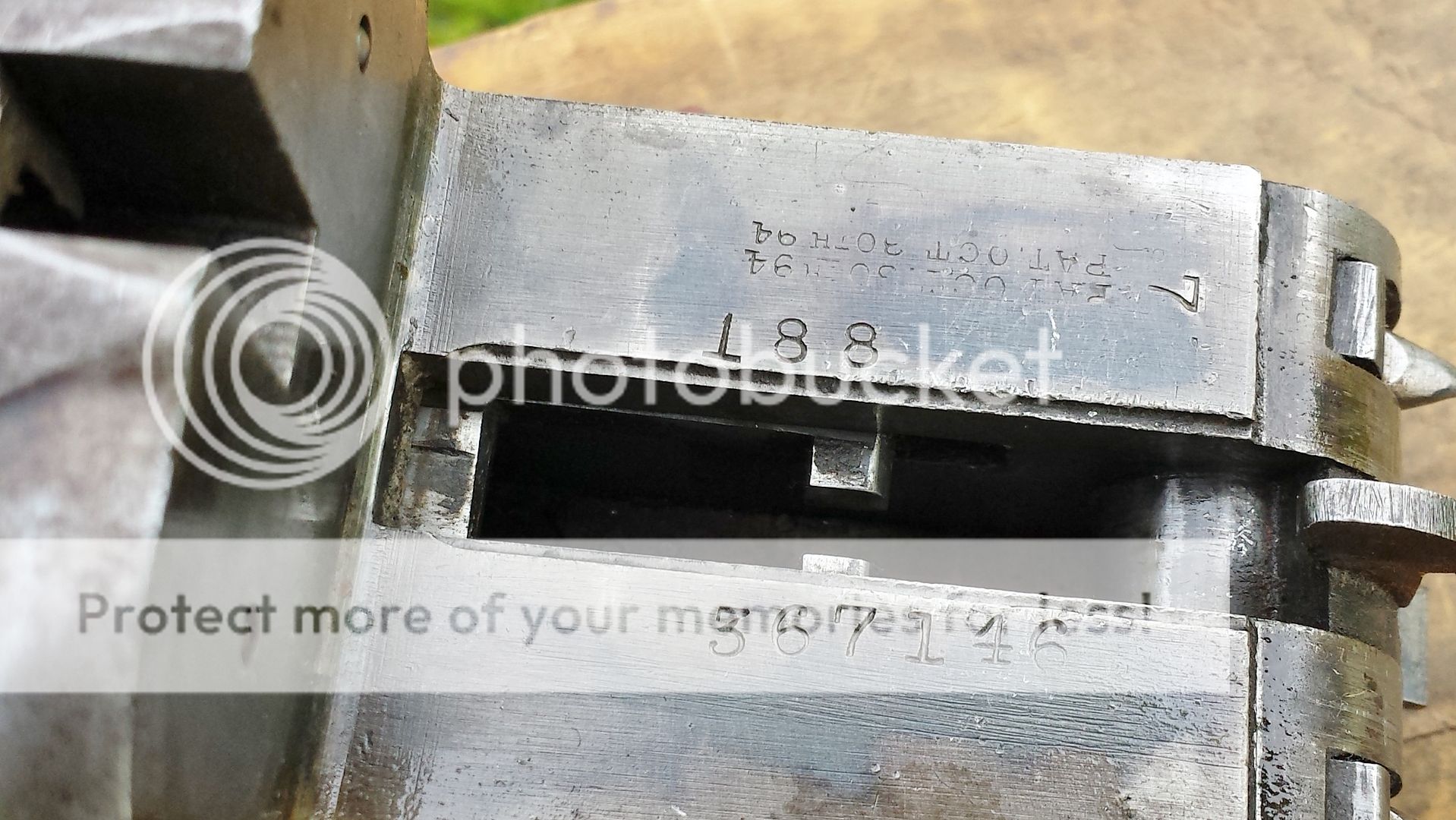

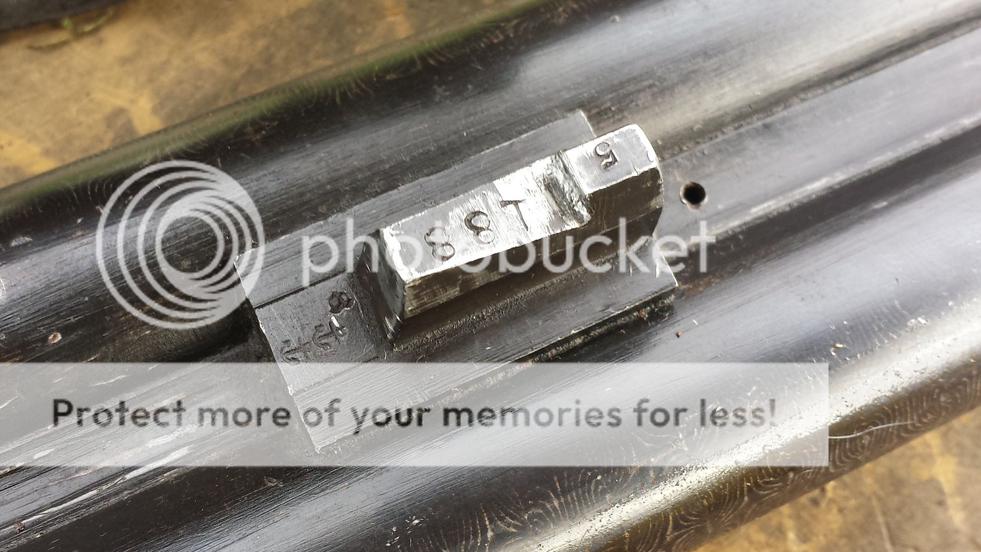

While photographing it for listing, I noticed matching marks on all three assemblies.
Either "188" - or - "88T"
This could be completely common on Remington 1900's, but it doesn't hurt to ask.

Those extra numbers which some refer to as "assembly numbers" seem to be pretty common on Model 1900s. The number here is 2282 but my poor photography skills makes that a bit hard to read.
