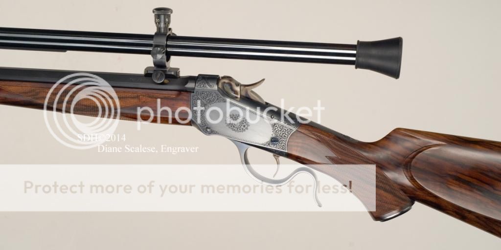

My fav small, low pressure action is the flat sided Low Wall and large/high pressure the dish sided high Wall. Both of these without modern scopes because of the extreme drop of the upper tang.

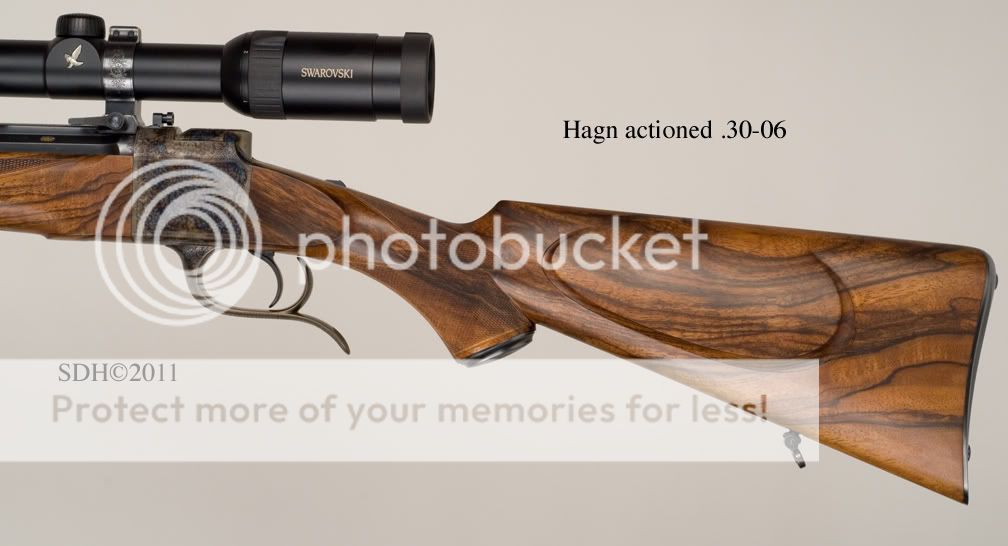

For a modern, hammerless scoped rifle action the Hagn, in any size format, simply has no peer.
THE FIRST AND LAST TIME I WILL EVER PUT A MODERN SCOPE ON A HIGH WALL!
LARGE HAGN ACTION, .30-06

I wouldn't complain about any of those and I agree about the best format of a highwall, but I prefer the thick-tang, scalloped low wall simply because it feels better in my hand. A thicker wrist just works for me better for some reason. But those are hard actions to find -although MVA will be or already is making them. That said, your .22 low walls in your first rifle book were the inspiration for mine. I don't think there is a better looking cartridge rifle anywhere than the 1885 Winchester.
