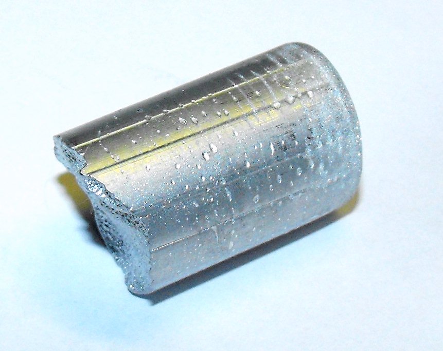

I see there are two different opinions above about this being a "Cape Gun". The Analytical Engineer in me brings me to this conclusion; I agree with you, I think the rifled barrel would do well with both Shot & Ball. Both Paradox Guns, and Shot & Ball Guns, typically have identical side-by-side barrels. So perhaps this gun would be best described as a "Combination Gun", or a true "Ball & Shot Gun". It would be interesting to locate an original 1930s advertisement for this Combination Gun to see how it was described to the Sporting World. But I don't think I'm off base calling it a Cape Gun.
I did a cast of 1 inch of the muzzle, and it measured .662 groove, and .652 bore, with 6 lands and grooves. Lands measure .140" wide, and grooves measure .200" wide. Rotation of the rifling appears to be slight over 1/2 rotation over the 27-1/2" length of the barrel. Seems it would be perfect for a patched ball of .662 dia.
I would guess that the lack of a rear sight would indicate the right barrel, when loaded with a ball, would be used at fairly close range. I will be testing to find out, and post the results here.

I guess that settles it. The shallow rifling was intended for shooting Ball, ... AND ... for the dispersion of shot at close distances.
So ... a Cape Gun ... or Combination Gun ? ? ?
