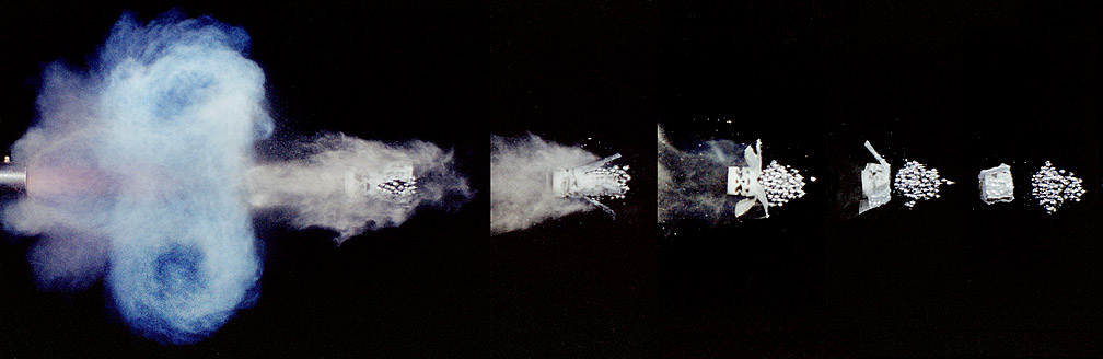

The most informative test I can imagine is a series of high speed photography shots of the various gauges being shot with adapters. A 12 gauge barrel , 16, 20, 28 and 410 chamber adapters, and a supply of shells should be all that is needed to photograph the exit shot stringsand answer this question. If anyone knows on of the people who post these types of tests on the internet, they should contact them and propose a series of tests.

I don't suppose there is any way to actually know what's happening in the bore with these under gauge wads unless someone was to build a clear barrel that would withstand the pressures, and use the high speed photography. That would be a "labor of love", though. I can see no financial incentives for going to that expense and trouble, especially given the limited usage/need of these inserts in the first place. They're no more than a curiosity to me. I just have a wondering mind.
