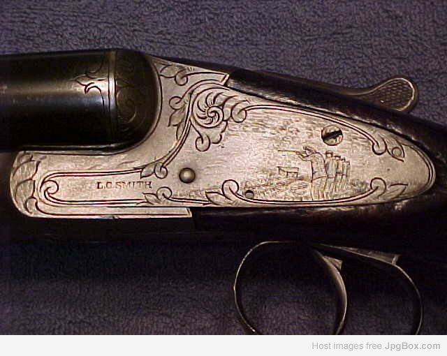

My Vintage gun

It's late, so I will try in the morning with the acetone. If you look at the hinge pin area in both pictures you can see remains of color pattern. Sure hope the acetone brings it back. If it does I will send new pics to Ted for reposting...if you don't mind Ted?

Well, the results are in...it was the lacquer, the color is back. Before I send Ted updated pics, I'm gonna do a thorough cleaning.

I would advise caution and patience. The solvent used to remove the lacquer would likely also damage your stock finish. And removing the stock from an L. C. Smith is far from the easiest home gun repair job you might attempt.
Actually, taking them apart isn't all that hard, assuming you have the correct hollow ground screwdrivers to do it without really screwing up the screw slots and surrounding metal.. Getting them reassembled is the hardest part. If you dislike darkened lacquer, you will really hate buggered screws, scratches, or stripped threads, etc. while fighting the top lever spring. Do a little research on that before you decide to jump in.

My opinion is, screw the lacquer. I don't use it on my guns with case color remaining and don't intend to. Keep a light coating of oil on them and keep it them in the dark.
Congratulations, Carl. Glad you had a successful outcome.
