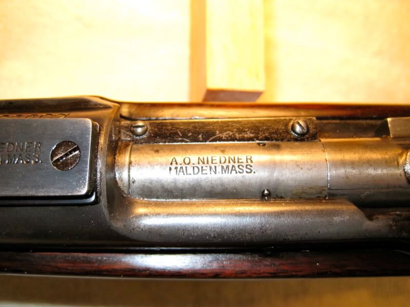

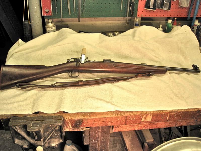

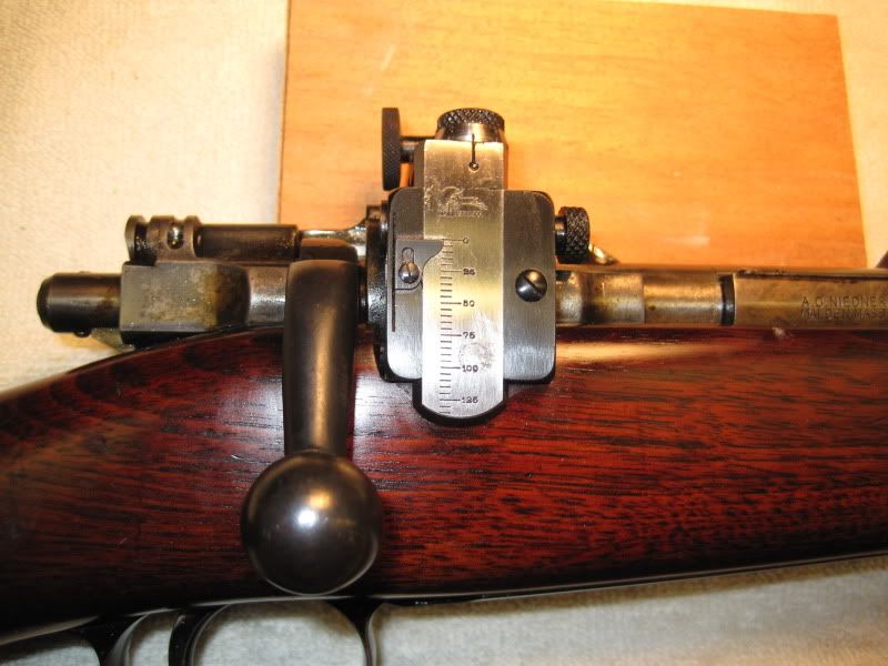

Scot, Welcome to the forum.
We need pictures and information in order to help you. What is the action serial number,and is there a date on the underside of the barrel?
Does it look like this one?
Bigger Picture

Yes it looks like the picture. I have read FAQ on sending pictures but it seems to be written in greek and beyond my skills in any event. Delighted to email photos to any and all. I did email photos to M. Petrov yesterday as I recognized his name from a book I have. Hope you received them and if not, will try again. Thanks to all.scot

Niedner’s conversion consisted of a “V” trough held in place by four screws, two screws through the left side of the receiver and two into the right raceway. The bolt is a two-piece bolt that has a non-rotating front “V” section with the original safety lug now acting as the locking lug. A stud on the side of the bolt that stops against the magazine cutoff controls the length of bolt travel. With the cutoff in the middle position the bolt can be removed just as in the normal 1903 Springfield. The barrels for these conversions were made by Niedner and have a Niedner chamber with a fourteen-inch twist. The cocking head is removed from the bolt and the sear has several holes drilled in it so as to lighten the striker and speed up lock time. All that I have data on are chambered for the .22 long-rifle cartridge.
These rifles were never meant for the military, although when one of them does come up for sale they are sometimes advertised this way. Most went to members of the Boston Rifle and Revolver Club. I am not sure how many of these conversions were made. I have catalogued ten and have reference to maybe four more and would guess that no more than twenty of these conversions were made.
Most that I have information on are single shots but Niedner did make at least two with a five-shot magazine. This is a slick operating rifle. You just drop the cartridge in the trough, close the bolt and fire. Extraction and ejection are flawless.
Many of the rifles still have the Niedner barrel. It will be marked on the bottom of the barrel with the Niedner barrel number and the date. The two rifles pictures are marked 245 12-1916 and 251 5-1917. The top of the barrel as well as the tops of the bolts and right sides of the “V” trough are marked in two lines with his standard Malden marking.
A. O. NIEDNER
MALDEN, MASS.

Nice to see it still has the Mann-Niedner scope blocks, were you lucky enough to get the scope?
If you can share the serial number and if it has a date on the underside of the barrel I will try to look it up for you in the shop books.
