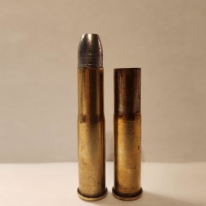

Brass:
Have 40 empty Bertram 43 Mauser cases, plus 20 more when the Buffalo Arms black powder loads get shot up.
Bullets:
Have 100 Hawk 400 grain .446 dia. .025 jacket thickness bullets
Have 50 Buffalo Arms 340 grain .446 hand cast lead bullets with some sort of lube in the three grooves.
I plan on loading up some of the empty brass with 400 grain Hawk and 340 grain Buffalo Arms with the nitro for black starting loads. Any suggestions on this?
Any thoughts on the observations above on the 30 yard shots?
With black powder, do you run a brush or patch between shots? I have a bore snake that’s easy to take to the field. Had never shot black powder and the smoke was glorious! If you clean between shots, do you add anything to a patch, like Hoppes Black Powder Bore Cleaner?
Cleaned up the brass with Dawn and hot water, crazy how much gunk is left in the brass.
On reloading brass that was shot in the double, would you recommend full-length resize or just run the neck up to seat the bullet?
The difference between the virgin and shot brass is a slightly sharper shoulder a bit farther out. Anything sketchy about this? The gun closed and opened just fine, no sign of pressure.

Appreciated the die adjustment/loading advice as well, need to preserve these cases for as long as possible. The virgin brass necks are too tight to seat a bullet so will need to go through the expander ball process, at least that's what I assume. I can do the same process w/magic marker and adjusting so it doesn't get full length resized, correct?
Interestingly the Buffalo Arms cases were made from 50-110 whereas the Bertram looks straight-up 43 Mauser.

Mike, hope my collection of 60 cases lasts a while and I'll be on the lookout for more but very nice to know that other cases can be converted.
I have the Lee 2 die set and looks like I'll need the universal flaring die to open the mouths a bit more for the lead bullet.

I have the Lee dies and use their flaring tool. I used a .457 sizing die for years, which sized nothing and weeped something terrible. I finally broke down and bought a proper die from BACO and I don't remember what it is...lol!! I bought by size that wouldn't touch the sides, just not leak so much lube....and I don't remember my bore groove either. I guess I need to shoot it more, huh.
