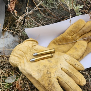

Shot a Scherping double rifle in, allegedly, 43 Mauser, for the first time this weekend. The tiny front sight blade is very hard to see nested in the fixed notch rear sight, not sure how consistent my hold was. It has one fixed blade, a flip up 200 yard blade, and a flip up tang ring, FYI. Please pardon my ghetto target, humped it up a hill and clipped it to a juniper.
**Seeking any suggestions, advice and comments.
Rounds shot on this first attempt were Buffalo Arms 43 Mauser (11/15x60R) Black Powder Ammo, 385 Grain.
Shot 3 left/right combinations.
First was at 50 yards and nothing hit the paper (!).
Second was at 30 yards.
Hits were roughly 4” high, 2” right for the right barrel, 2” left for the left barrel.
Third was at 30 yards.
Similar hit with the right barrel, left was close to the bull’s eye, but zero trust that I held correctly, could be a “flyer” in the right direction.
Brass:
Have 40 empty Bertram 43 Mauser cases, plus 20 more when the Buffalo Arms black powder loads get shot up.
Bullets:
Have 100 Hawk 400 grain .446 dia. .025 jacket thickness bullets
Have 50 Buffalo Arms 340 grain .446 hand cast lead bullets with some sort of lube in the three grooves.
I plan on loading up some of the empty brass with 400 grain Hawk and 340 grain Buffalo Arms with the nitro for black starting loads. Any suggestions on this?
Any thoughts on the observations above on the 30 yard shots?
With black powder, do you run a brush or patch between shots? I have a bore snake that’s easy to take to the field. Had never shot black powder and the smoke was glorious! If you clean between shots, do you add anything to a patch, like Hoppes Black Powder Bore Cleaner?
Cleaned up the brass with Dawn and hot water, crazy how much gunk is left in the brass.
On reloading brass that was shot in the double, would you recommend full-length resize or just run the neck up to seat the bullet?
The difference between the virgin and shot brass is a slightly sharper shoulder a bit farther out. Anything sketchy about this? The gun closed and opened just fine, no sign of pressure.
Thank you for any insights. The plan is to get this regulated as close as possible and use the heck out of it.
