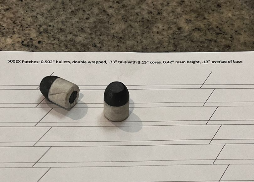

Next, two of the patched Bear Creek Supply 340gr bullets on top of the Excel template used to make cutting the patches go faster.
![[Linked Image from hosting.photobucket.com]](https://hosting.photobucket.com/ef477c67-1177-4902-ac5a-0357556b39c6/d9aced89-cc9e-4cc0-968b-7900597cb73b.png)

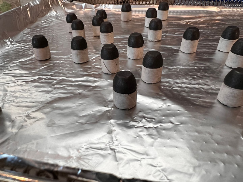

The patched bullets as they came out of the air fryer, which has a dehydrate function I used to dry these more quickly (not sure about having lead in a cooking device!)
![[Linked Image from hosting.photobucket.com]](https://hosting.photobucket.com/ef477c67-1177-4902-ac5a-0357556b39c6/7ed8c69a-68b4-46f2-a170-b83af4b70d0a.png)

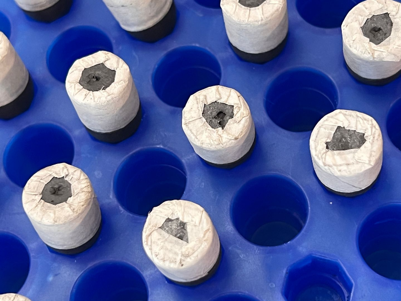

The bottom of some of these patched bullets, showing how far I still have to go in terms of consistency
![[Linked Image from hosting.photobucket.com]](https://hosting.photobucket.com/ef477c67-1177-4902-ac5a-0357556b39c6/d917703a-d65c-4bc6-9cd0-6c932138e300.png)

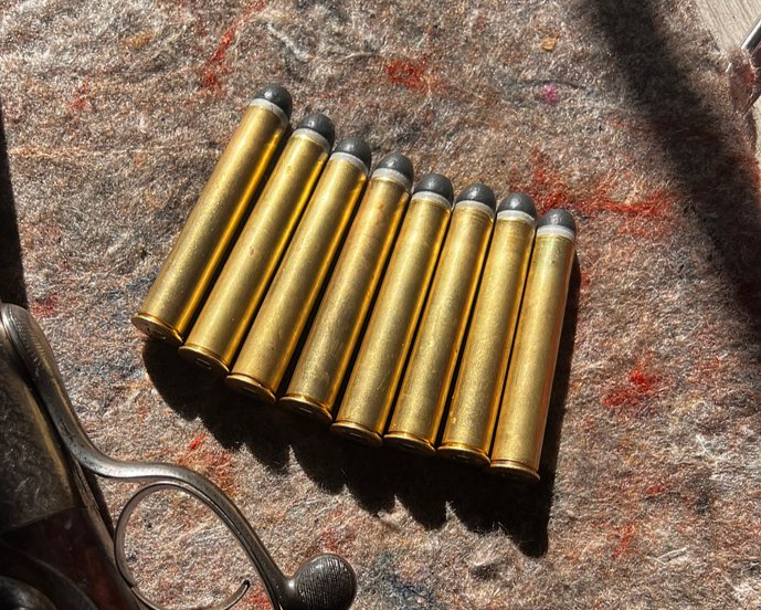

And finally, the finished product
![[Linked Image from hosting.photobucket.com]](https://hosting.photobucket.com/ef477c67-1177-4902-ac5a-0357556b39c6/885f23f6-fca6-41ae-8163-00a0aca41150.png)
