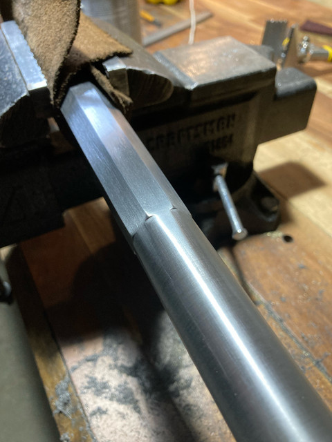

Attached is a picture of the round portion of a barrel turned to match the outside dimension of the octagon flats. This would achieve the largest barrel diameter.The points of the octagon have been filed down to transition to the barrel o.d.
Unfortunately that doesn’t answer your wedding ring question.

Thanks for these posts. They are exactly the type of information I am looking for. I really like the band that is cut into the round rather than sitting above the round. If the barrel is first turned to look like what Ken as posted, then it could be carved to look like what LRF posted.
