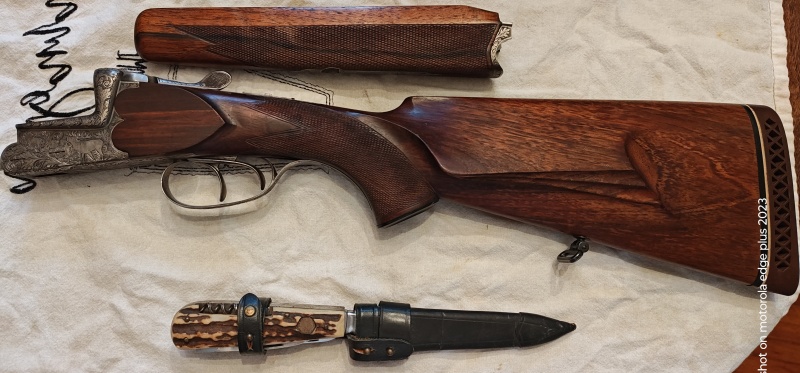

I have been fortunate to pickup a Kombo by Michael Pegam from 1950 and retailed by GECO. Somehow the Austrian Makers were out of the gate early with weapons production & GECO was eager to fill inland orders. Michael Pegam passed this life in 1947 and his widow continued the business until @ least 1953, when arms production was allowed. Interesting how mass production was not allowed but GECO could still place orders with Ferlacher mechanics.
60.5 cm tubes chambered in 7X57R(11,2 gramme bullet) and 16 Bore. I seem to really find favour in these short tubes and dainty little platforms.
Bayerische Backe, Bavarian style stock. Does the forend chequering and that of the stock seem to pair?

Again, a dainty little platform with a frame w/ a Single Kersten Lockup. Bushed & Disk Set Strikers and for some reason the foto depicts what looks to be issues with the top striker set but that is just not the case.

What a great find! Just from glancing at the pictures, maybe the forend checkering was refreshed vs. a different style? Hard to see.
I'm assuming disked strikers are not often seen in combo guns, is that correct? I haven't looked closely at very many, but have never seen that outside of higher-end shotguns and double rifles.
Thanks for sharing!

Well, this was made during the >>British Period<< in Ferlach under British Occupation so I just am not sure what the norm would have been. I will take a few more fotos as I am most curious. I just do not think that GECO did a restock and the scope & feet are a little odd. The Bayerische Backe / Bavarian style stock is typically for better target acquisition with iron sights and the one leaf is stamped >>200<<.

The head of the stock is just a little proud @ the frame.

Raimey:
"The Bayerische Backe / Bavarian style stock"
to be exactly: Bayrische Backe mit Doppelfalz - a more exquisite version....

Many stock makers prefer Bayerische Backe to the German Backe; not for technical reasons, but because it is easier to cut the rear part and yet it is often an extra cost option (they are cut with a draw knife after roughing out with a straight bandsaw cut, much faster and easier than gouges, chisels, and rasps/files).
