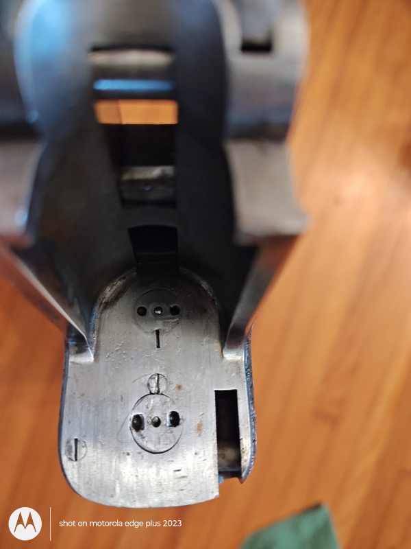

Again, a dainty little platform with a frame w/ a Single Kersten Lockup. Bushed & Disk Set Strikers and for some reason the foto depicts what looks to be issues with the top striker set but that is just not the case.

What a great find! Just from glancing at the pictures, maybe the forend checkering was refreshed vs. a different style? Hard to see.
I'm assuming disked strikers are not often seen in combo guns, is that correct? I haven't looked closely at very many, but have never seen that outside of higher-end shotguns and double rifles.

Well, this was made during the >>British Period<< in Ferlach under British Occupation so I just am not sure what the norm would have been. I will take a few more fotos as I am most curious. I just do not think that GECO did a restock and the scope & feet are a little odd. The Bayerische Backe / Bavarian style stock is typically for better target acquisition with iron sights and the one leaf is stamped >>200<<.
