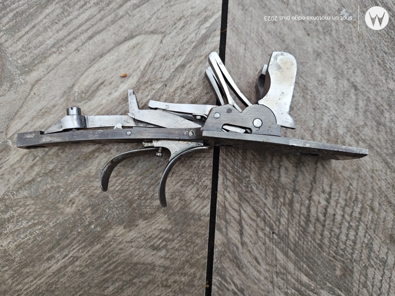

Anyone fancy a few fotos of the internals of a 1950 Blitz Ferlacher???
The scattergun trigger pull is just horrid & I had intended on stoning the scear. But on a Blitz it just may be a bit more involved.
Empirically, it seems that for disassembly it is best to have the locks out of battery and then in battery for re-assembly? I could easily be wrong.

Just from a foto, does the nose of each scear seem too vastly different?

I for one found it interesting how the right hammer was designed to accommodate the spindle upon impact.
You can see the end of the two strikers and get an idea of the angle to which it mates with the primer. Too, this one has an automatic safety(which I detest) that can easily be removed.

So everyone is mum or tight-lipped on the subject of the Blitzschloß¿ I realize the Blitzschloß is quite complicated due to its construction and maybe the scears are harder than hammered Hell. An error could lead to doubling.
