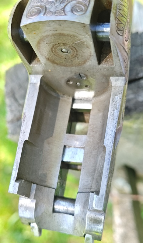

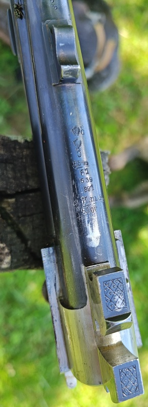

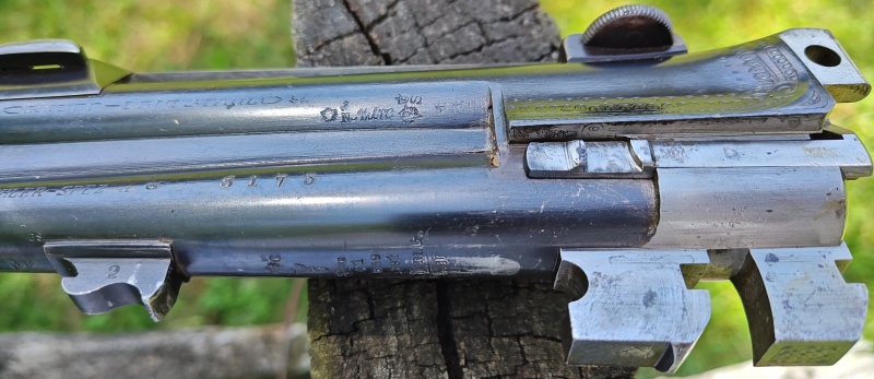

Some kind soul graciously allowed me to take this August Jung Viernau - Thueringen retailed 5.6x61R vom Hofe Super Express War Trophy off their hands.
62 cm tubeset w/ 36 cm LOP
5,5mm
61mm
539
891
5,1 gramme bullet(K.m.G.)
Krupp up top & Böhler Spezial on the bottom.
Blitz Platform w/ Non- Auto Safety
Any starting load data coupled with a bullet weight & diameter would be most appreciated¿

Assembled Kombo weighs 3.03 kg & tubeset weighs 1,461 grammes, but of course there isn't a weight stamp.

Indeed & all the Kombos have 62 cm tubeset length, are quite similar in shape & form, have the 1/2 Pipe Side-Frame Reinforcement & according to Axel E. they were made by Christoph Funk, but the bulk of them passed thru the Z-M Proof Facility and one just doesn't see Christoph Funk's mark. Of course it could be hidden & gearing up for the 2nd Major Disagreement in Europe, the Suhl Proof Facility might have been very busy with instruments of War?

Too, most of Z-M stamped touchmarks I have viewed give a 5,1 gramme(79 grains) projectile. I realize there's not a huge difference to the 70 grain. I guess maybe the bullet weight & powder charge were the same number, just move the decimal, just to make things easy?
