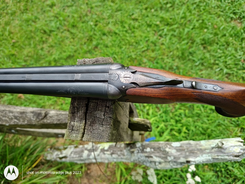

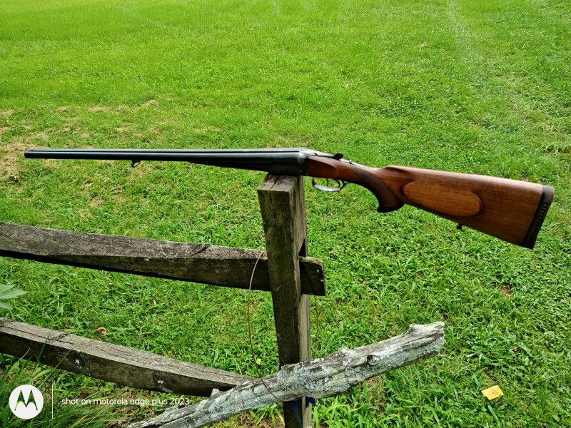

Was very fortunate to acquire, after a lengthy bidding frenzy, a 1914 Ferlacher A&D Body Action in 24 X 24 and a Biks in 24 X 222 Rem as of 1966 and it looks to have been a 5.0+mm in 1914. What Rimmed 22 kaliber would an Auerhahn / Capercaillie Hunter have preferred @ the onset of WWI??
Too, I am curious as to the top rib cuts on the Scattergun tubes and the type scope mounts on the Cape/Biks.
I really like how the forend lever is addressed with a skosh bit more thickness.

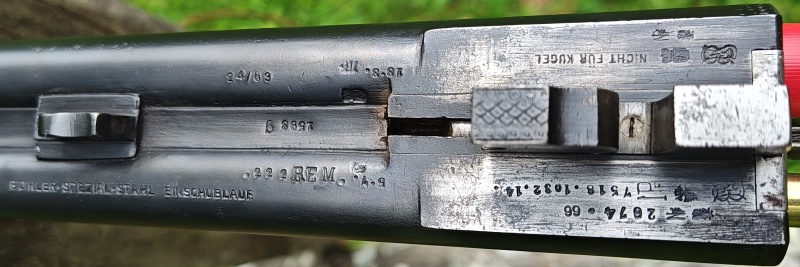

The Biks / Cape Tubeset length is 69.5 cm whilst the 24 X 24 tubeset length is 64.5cm
>>Einschublauf<<; the otherside is 24 bore(X69mm)

The 24(69mm) X 24(69mm) tubeset is stamped 1140 grammes & my Trusty, Dusty, Rusty Kat Certified Kitchen Scales measures 1107 grammes.
The 24(69mm) X 222 Rem. tubeset is stamped 1598 grammes and Trusty, Dusty, Rusty Kat Certified Kitchen Scales measures 1520 grammes.
The original 22 chambering must have been 22 WCF? But why switch to 222 Rrem. being a rimless cartridge?

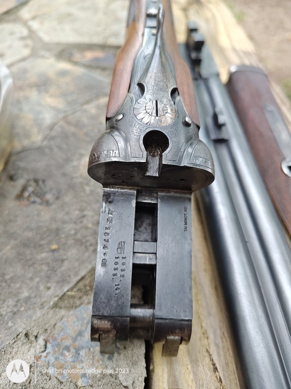

After checking, I see your chamber is not cut for a rimmed case, and I can just see the end of a spring-loaded pin extractor, let me know if you need 222 cases. BTW, the scope mount bases seem to be either EAW or Recknagel swing mounts and New England Custom Guns can likely set you up with rings,
