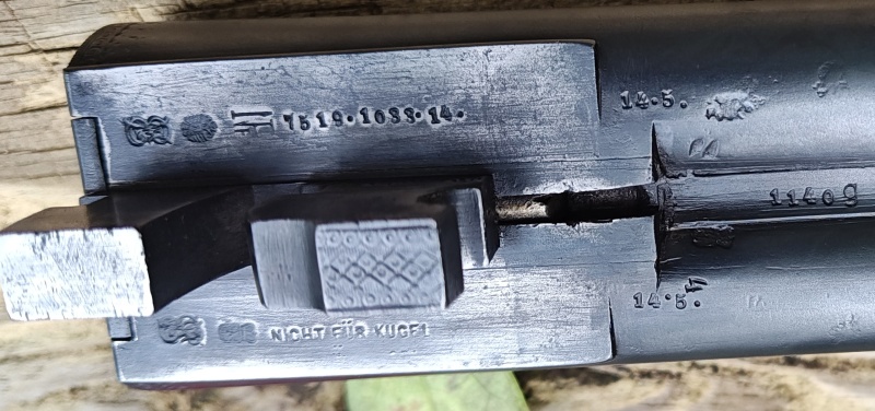

The fore to aft width of the Front cut is 0.4"
The separation between the fore & aft cuts is 2.5"
The width of the aft cut is 0.3".
The width of the top rib in the area between the cuts is 0.370"
Hochachtungsvoll,

Jani is due the credit, if any, on making me aware of something akin to >>Hair Rifling<< or similar. As in the 24 bore tube of the Biks there are some odd striations. Now I have not shot it nor cleaned it. So take it for what it is worth. The other 24 bore tubes do not have such and are quite rough.
Hochachtungsvoll,

Well, after a cleaning, odd striations are apparent remnants in the 24 X 24 tubeset?
Someone didn't clean w/ a stainless brush & make these???

Those lenghthwise grooves in the shotgun tube set are really odd. Remnants of some sort of rifling, maybe straight rifling? Or signs of shoddy manufacturing or whatever mistreatment?
Mixed with pitting and all sorts of scratches, what can one say?
But since there seems to be choke boring, I'd say these barrels were intended for shot, not for some kind of bullet.
