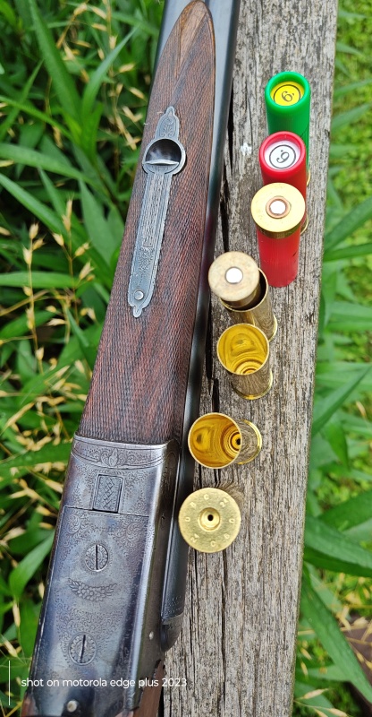

Originally Posted by ellenbr
Should I use semi-smokeless or Black?
Fibre, Cardboard or other cards???
That's a 500 Express dropped in one case....
Hochachtungsvoll,
The cape gun barrels have nitro proof, so I assume the shotgun barrels will have the same.
I would use 2 1/2 shells, despite the "69" marks, use as wads whatver I can get, stick to modest shot and powder loads, and stay away from experiments with slugs or ball.
BTW you have not told us if the barrels are choked
