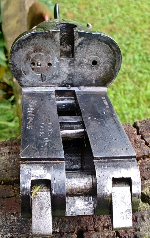

I forgot to post a foto of the Standing Breech, which wears a bushed and disk set striker for the rifle, which is a true sign of a Biks(Biksarica / Cape).
Hochachtungsvoll,
