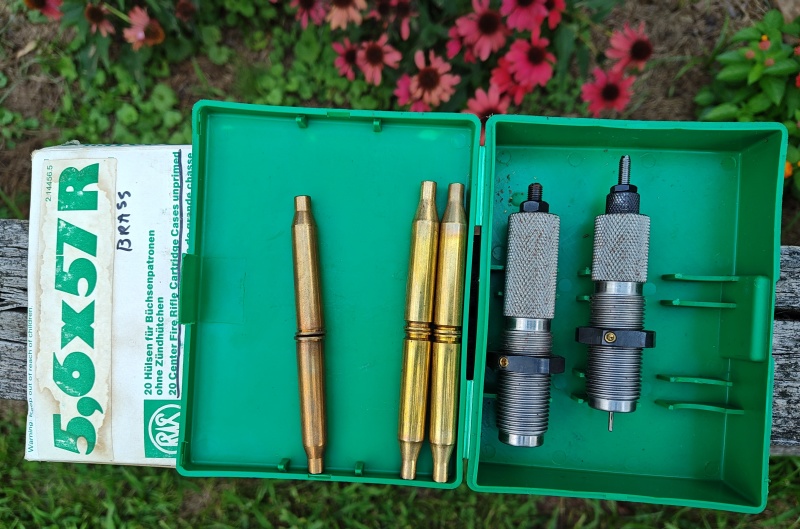

Ford, it is most easy to discern between the 5,6X61 vom Hofe and the 5,6X61R(Rand) vom Hofe: One has a Rim(Rand) & one does not. Sort of akin to a dog w/ a tail & a dog without a tail....
I finally found my brass & dies plus I have some Rimless so I need to source a bolt gun.....

The box is marked 5.6x57R, Is the rifle 5.6x61R vom Hofe or 5.6x57R? Are you looking for a 5.6 x 57 or 5.6x 61 vom Hofe bolt gun? I think I have some fired 5.6x57 cases, if you need them and maybe some 5.6x57R also. I can stake you to some 5.6x57 ammo to check your handloads against. The biggest advantage goes to the 5.6x57 over the 5.6x61 vom Hofe (both rimmed and rimless) because it uses .224" bullets and a common case head diameter. BTW, I noticed two of the fired cases have the unique venturi shoulder. This is more common on the 7x66 vom Hofe, than the 5.6 x61.

Just seeing if you are paying attention. Yes, the rifle is stamped 5,6X61R but about 20+ years ago someone proffered me several boxes of the aforementioned 5,6X57R thinking those would bridge the gap in a Vom Hofe and those were the brass for which I was searching for but do not fit in well with what I am trying to do. How difficult it is to put a Rim on a Rimless??? I am quite confident I have a handful of 5,6X61R laying about somewhere plus I still need to order some of the bullets you posted & referenced.
