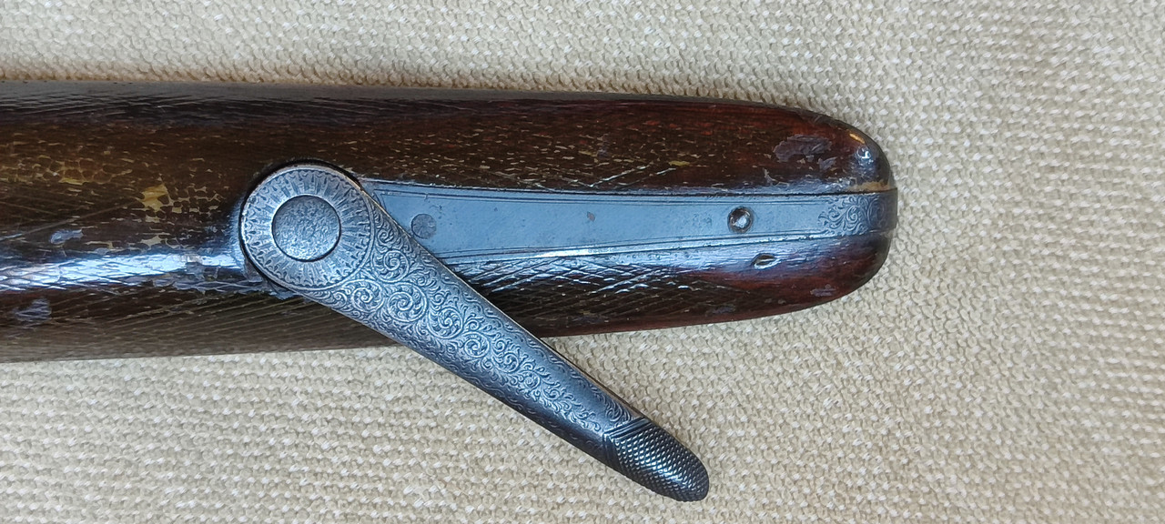

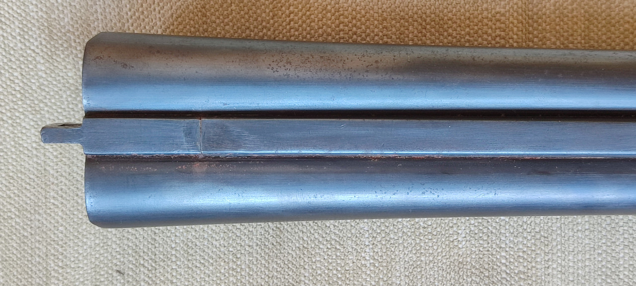

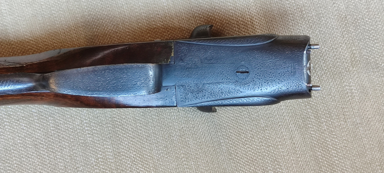

Hello all
I have been given an old WC Scott & Sons shotgun.
It needs a lot of TLC and attention: checkering has gone, finished in lacquer, unsoldered ribs, and more... But it is a good base.
I am unfamiliar with Scott guns and would like to know more about the year of manufacture, model, etc.
I am sure here are Scott experts that can give me information.
[img]https://i.postimg.cc/pLQ2PB75/IMG-20250731-114429.jpg[/img]
[img]https://i.postimg.cc/tgX9JxQS/IMG-20250731-114507.jpg[/img]
[img]https://i.postimg.cc/JhPMkzR1/IMG-20250731-114521.jpg[/img]
[img]https://i.postimg.cc/xC8YyVdL/IMG-20250731-114625.jpg[/img]
[img]https://i.postimg.cc/fRQz4PHh/IMG-20250731-114658.jpg[/img]
[img]https://i.postimg.cc/GmtX4BNL/IMG-20250730-173343.jpg[/img]
[img]https://i.postimg.cc/6QGzhktF/IMG-20250730-173538.jpg[/img]

For starters, you will want to get your hands on the book on the subject: "The History of W. & C. Scott Gunmakers
By J. A. Crawford and P. G. Whatley
It contains a lot of photos which will help you Identify which model you have.

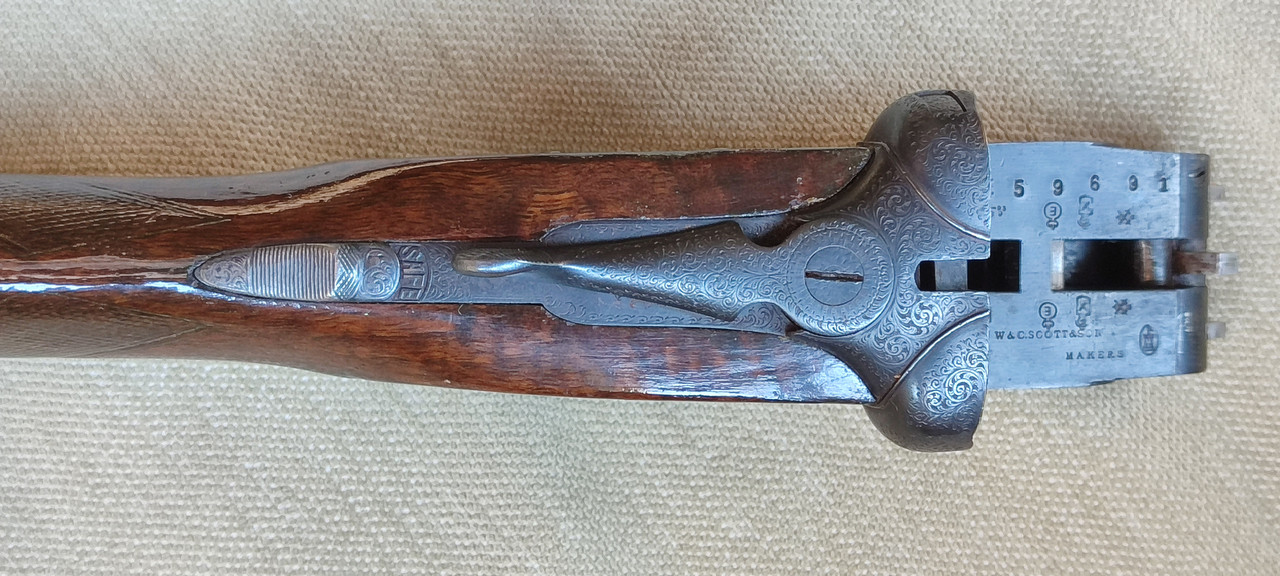

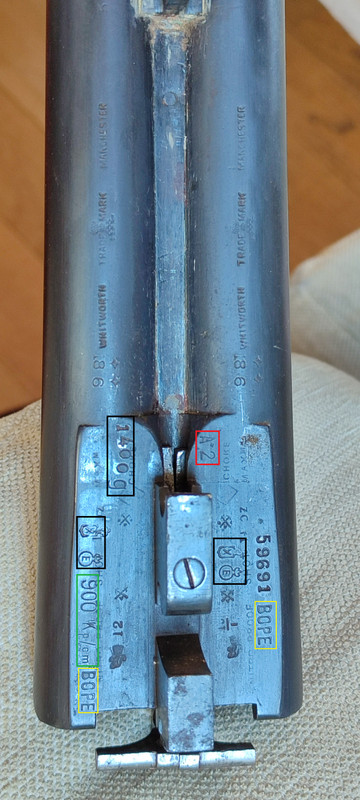

Serial number indicates manufacture in 1898.
Whitworth Steel barrels are always an indication of high quality.
Posts: 10,011
Likes: 617
Posts: 10,011
Likes: 617
Which fits the original proof marks of 1896-1904 and likely with 2 1/2" chambers
The R bore was 12 = .729" - .739"
L was (I think) 13/1 = .719" - .728"
The Spanish proof date code A*2 is 1981, after slight honing to 18.6 mm = .732. What is the chamber length now?
I believe the 2 stars indicates Improved Modified choke. One star would be Full.
It was proved at 900 kg/cm2 for a service load of about 9500 psi
Cornell Pubs has an 1899 catalog repro. It might be available as a PDF and would show the model
https://www.ebay.com/itm/291034041363
It appears that the top rib extension, and possibly the barrel hanger, were reattached at some point.

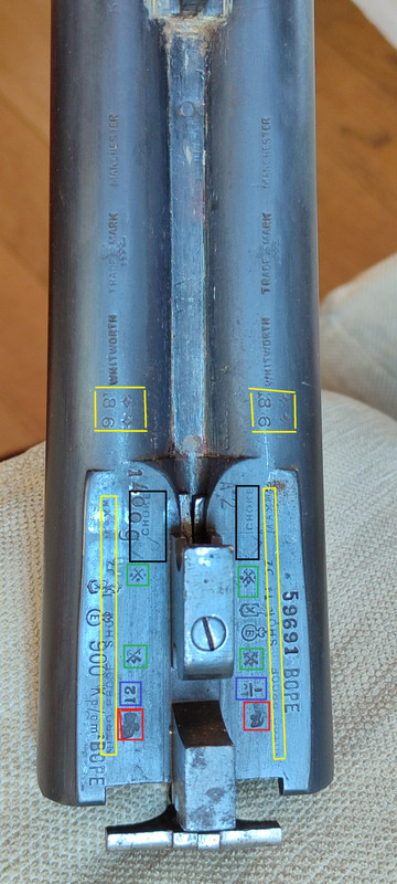

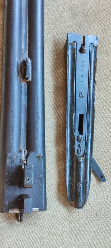

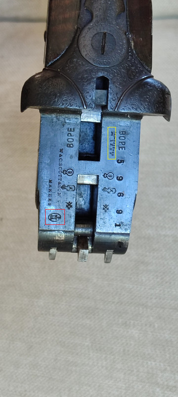

Drew, Your information is most valuable!!!
I have taken the opportunity to make 2 images, one for the English marks, and one for the Spanish marks, maybe you can help me identify exactly each ones?? I know the spanish ones, so this would help others
ENGLISH MARKS
NITRO PROOF SHOT XXXX MAXX???
Stamp in green??? why 4???
The R bore was 12 = .729" - .739" Blue
L was (I think) 13/1 = .719" - .728" Blue
Red stamp???
Diamond & Choke and mark in black???
SPANISH MARKS
A*2 in red, date of proof: 1981
BOPE in yelow: Banco Oficial de Pruebas de España (Oficial spanish proof house)
Stamps in black: BOPE stamps
1400g en black: barrel weight
900 in green: proved at 900 kg/cm2
The stars are spanish stamps??
OTHER
Stamp in red???
Patent in yelow???
I will get those catalogues, thanks

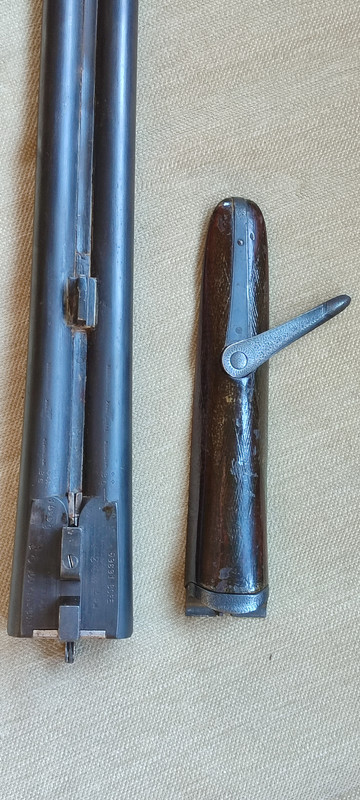

The ribs are unsoldered. I think they made an acid bluing, that destroyed the soft solder, that is why they are loose.
Posts: 10,011
Likes: 617
Posts: 10,011
Likes: 617
re: the Spanish marks, I don't find the mark in red on the action flats here
Yes, the marks in yellow are Scott's patent. I can't read the date or number.
I appears to be a flag on a castle? It may be the mark of the importer, who could have been a gun maker?
The stars on the barrels are not a proof house mark and frequently found, having been placed by the maker, indicating choke.
1 star = full, 2 = improved modified, 3 = modified, 4 = improved cylinder, 5 = cylinder
