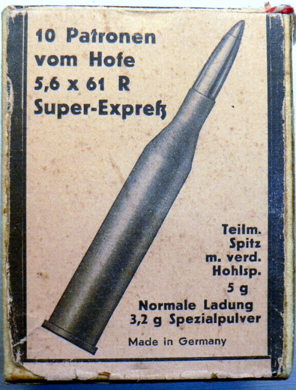

I have 80 grain hollow point bullets.
But the more I read & stare @ possibilities, the more I think they may have used Rottweil R5, which takes me to VV N 140. I will see if a measure of VV N 140 in the high 30 grains fills the case to say 90%??
I lifted this image from somewhere but it gives 3,2 grammes of„SpezialPulver„. .
Hochachtungsvoll,
