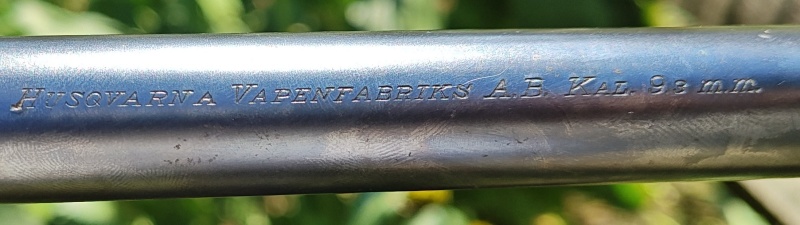

Nice looking rifle. If you click on the second pic, the closer-in shot. Then click on it again it greatly enlarges. The bbl markings show Kal 9.x (??) m.m.
I can't quite read what the unkn x number is. It almost looks like an 'S" or a '5' perhaps. But likely a 3 I'd guess from the common choices above.

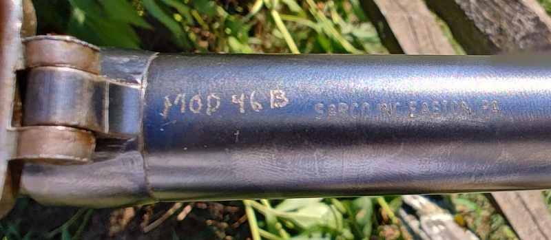

Good Eye Kutter, excellent notice...... ![[Linked Image from thumbs2.imgbox.com]](https://thumbs2.imgbox.com/4a/82/fuzkP6ja_t.jpg) Crown on the Underside of the Trigger, else the metal is devoid of any marks I can see. ![[Linked Image from thumbs2.imgbox.com]](https://thumbs2.imgbox.com/4d/69/wnbByQZ0_t.jpg) I typically do not cotton to Chicken Scratching w/ an electronic engraver, but this bit of graffiti speaks volumes, if correct: Modell 46B(more than likely a Modell 46A from the serial number list??). ![[Linked Image from thumbs2.imgbox.com]](https://thumbs2.imgbox.com/21/0c/dYy1qOiY_t.jpg) Husqvarna Vapenfabriks AB 9.3 mm It does have a Husky Buttplate. Hochachtungsvoll, Raimey rse
