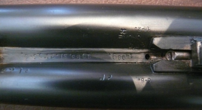

Thanks Ford. I saw another Borovlje drillilng & the stamp for some reason was »6.88«, but I assume the 2nd 8 was errant? I put some feelers out just this morning for anything associated w/ 6,5 & 6X70R....

Well, the Ferlacher stamped »6.88« was actually a Sigott Cape
Being a 2 Barrel Set......
And almost all these „Bleistiftpatrone = Pencil Cartridge“ chamberings seem to date between the mid 1920s to the mid 1930s(1928-1933)??
Another Borovlje Biksarica / Cape Gun

Ford, it appears that after sluggin' the bore twice the diameter is 0.265"-0.266", more or less. So would there be an issue w/ the 130 grain cast lead bullets w/ a gas check that came w/ the gun?

Raimey,
With that groove diameter, the bullets that came with the ammo would not be an "issue" at all. More importantly, you will not need to resize modern 6.5mm jacketed bullets. If you run across loading data recommending using .257" bullets, ignore that part. That is lucky for you, you will have enough trouble with cases.

To recap & refresh, can you elaborate on the Austrian bore measurement, which resulted in a stamp of »6.8«.
Who how & where did the Austrians measure??? So if you have an Austrian stamp of 6.8mm, and assuming it is accurate, would you ever expect the diameter of a slug to be 0.257" after sluggin' the bore?
And how & where did the Germans measure.....
