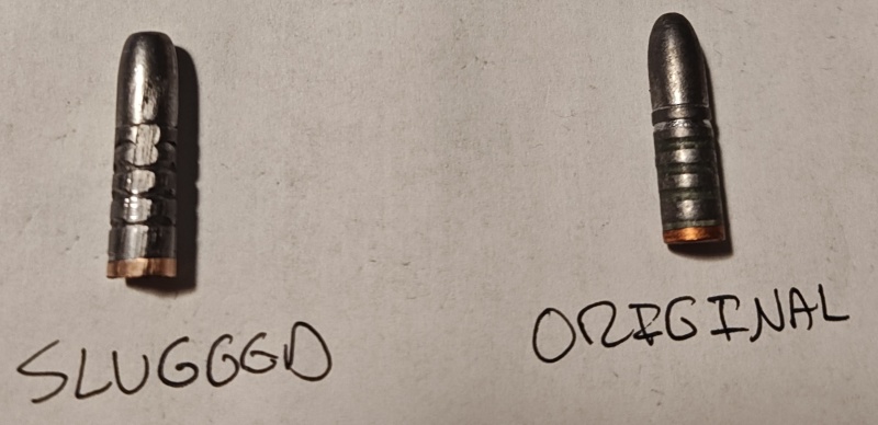

I again slugged it with one of the 130 grain bullets that accompanied it. What is the best method to obtain the smallest diameter of the bore; i.e., where is is best to measure on the slugged bullet? I assume rotate it a full round?
It is widely - maybe generally - not recommeded that one attempt (!) to slug a barrel with the whole bullet. For two resons.
Firstly, the bearing surface would be too long; it is preferred to use a somewhat oversized round ball (so that only a deformed driving band remains flat around the circumference), or a rather short cylindrical body.
Secondly, a plug used for slugging must be dead soft. Antimony-hardened lead (as in cartridge rifle bullets) or gas checks are inappropriate.
Thirdly, but you will certainly have observed this, the barrel and the slug should be well oiled. I mention this only for completeness' sake.

To measure the slug, measure across the lands of the slug to determine the groove diameter of the barrel. This is fine as long as the barrel has an even number of grooves and the mic. or caliper measures land to land on the slug. If the barrel has an uneven number of grooves the mic. will measure from land to groove and give an incorrect measurement unless you use a special micrometer made to measure such slugs. A correct measurement can be approximated by a couple different methods, one of which is to rotate the slug between the jaws of a dial or digital caliper as you mentioned. You don't have to rotate it a full round, if you are careful rotating over one land to the next is enough. Since a mic. operates by a threaded rod, it won't work for this method.
Carcano is correct that using a soft round ball, larger than the barrel, is much easier. I didn't comment because it was already done.
