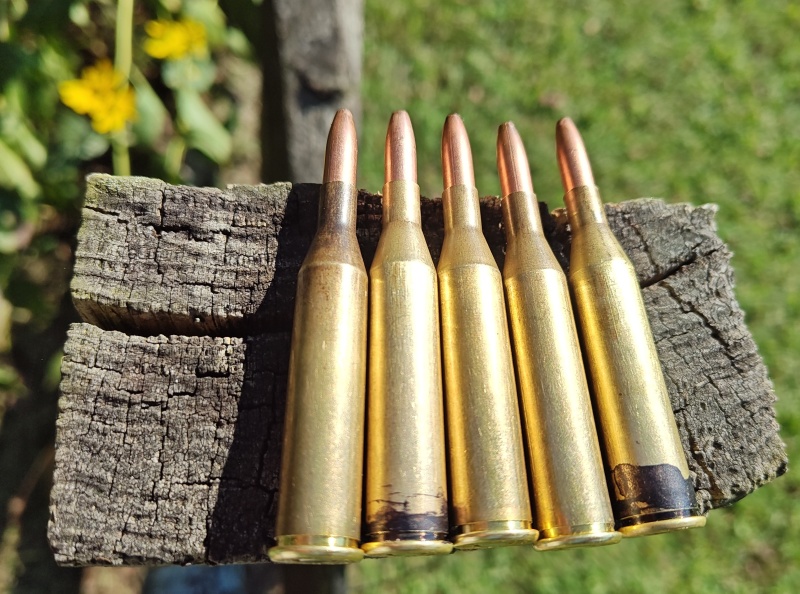

Alright, my second series of 5,6X61R vom Hofe Super Express loaded w/ 44.4 grains of VV N 160 behind an 80 grain Northern Precision Bonded Bullet.

Well, 3400 ft/s was easily to achieve in this morning's test w/ 44.4 grains of VV N 160 w/ a Northern Precision Bonded 79 grain bullet. I had one shot low in velocity; One @ 3200 ft/s; two that were 3425 on the nose and one that didn't register( this one may have been greater than 4k ft/s which would account for that?????). Zero signs of any pressure issues @ all but if the average continues to hover around 3400, I am officially done @ 44.4 grains. But it continues to be a Tack Driver, even with Iron Sights & trying not to shoot the Sunshades off.... It maybe, well it is the flattest shooting trajectory platform that I have ever shot. To put it into context, it is just chewing up a Evaporated Milk Can @ 30 metres with open sights. I can post a foto if there is interest..

I failed to mention that max case capacity for VV N 140 & VV N 160 is right around 55 grains. Therefore, 44.4 grains of VV N 160 nicely fills the case well into the shoulder.
