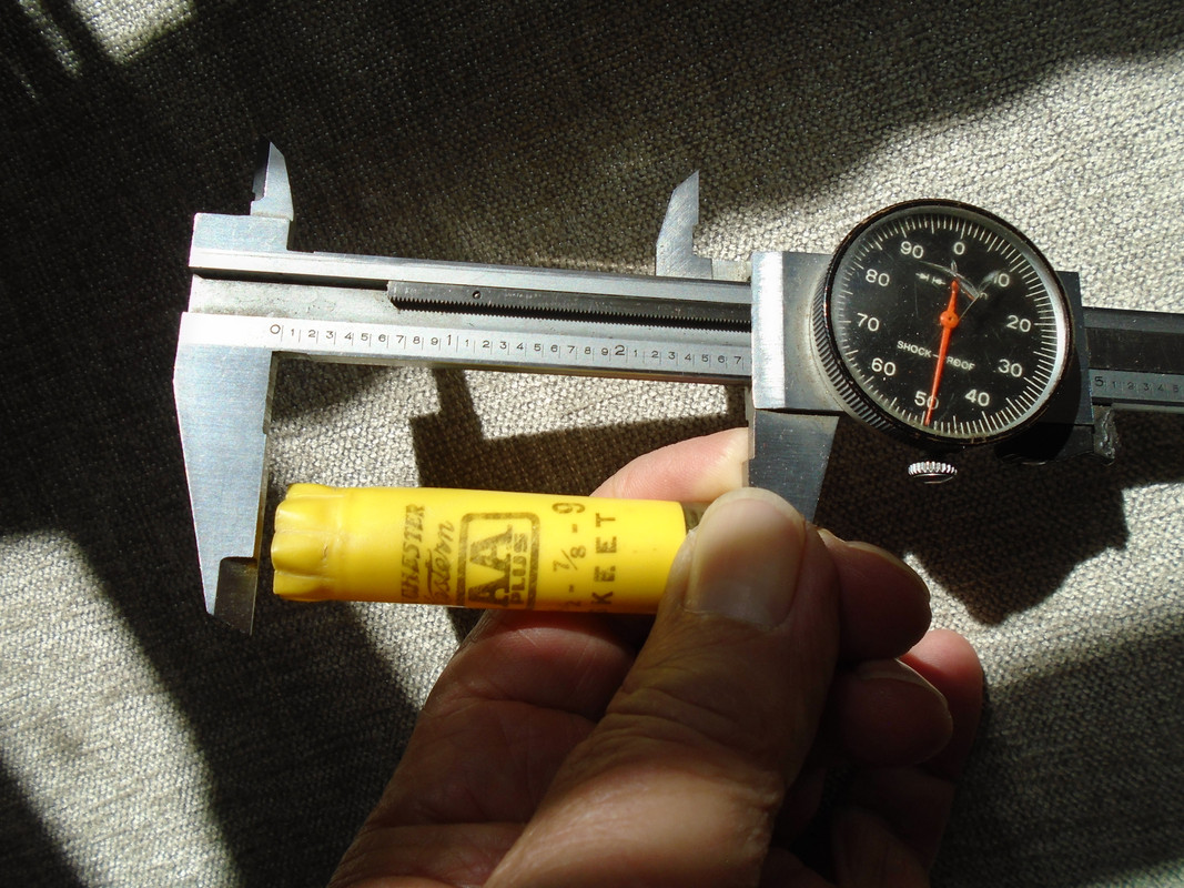

Low pressure 2 3/4" loads and roll crimp for the 2 1/2" hull. Or if you have old 2 3/4" Win AA hulls which are no where near 2 3/4". [Linked Image from i.postimg.cc]

I concur with Eddie. Roll crimping 2-3/4 data into hulls cut down to 2-1/2 is definitely the way to go.
I drew the max pressure line at 8,000 PSI, when picking data to try.
I should add most2-3/4 in 7/8 loads can be roll crimped with cut down 2-1/2 hulls.
