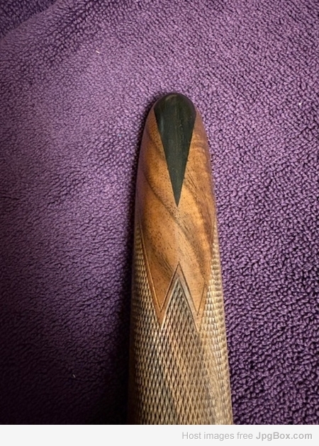

Stanton,
A few years ago, I was where you are. What I had was perfectly adequate but not what I really wanted. I had some African ebony on hand so I pulled the trigger. Definitely glad that I did. I hope you are, too.
(I will try to post a picture if I can get the new improved IMGUR to cooperate.)

Posted for FallCreeekFan:
