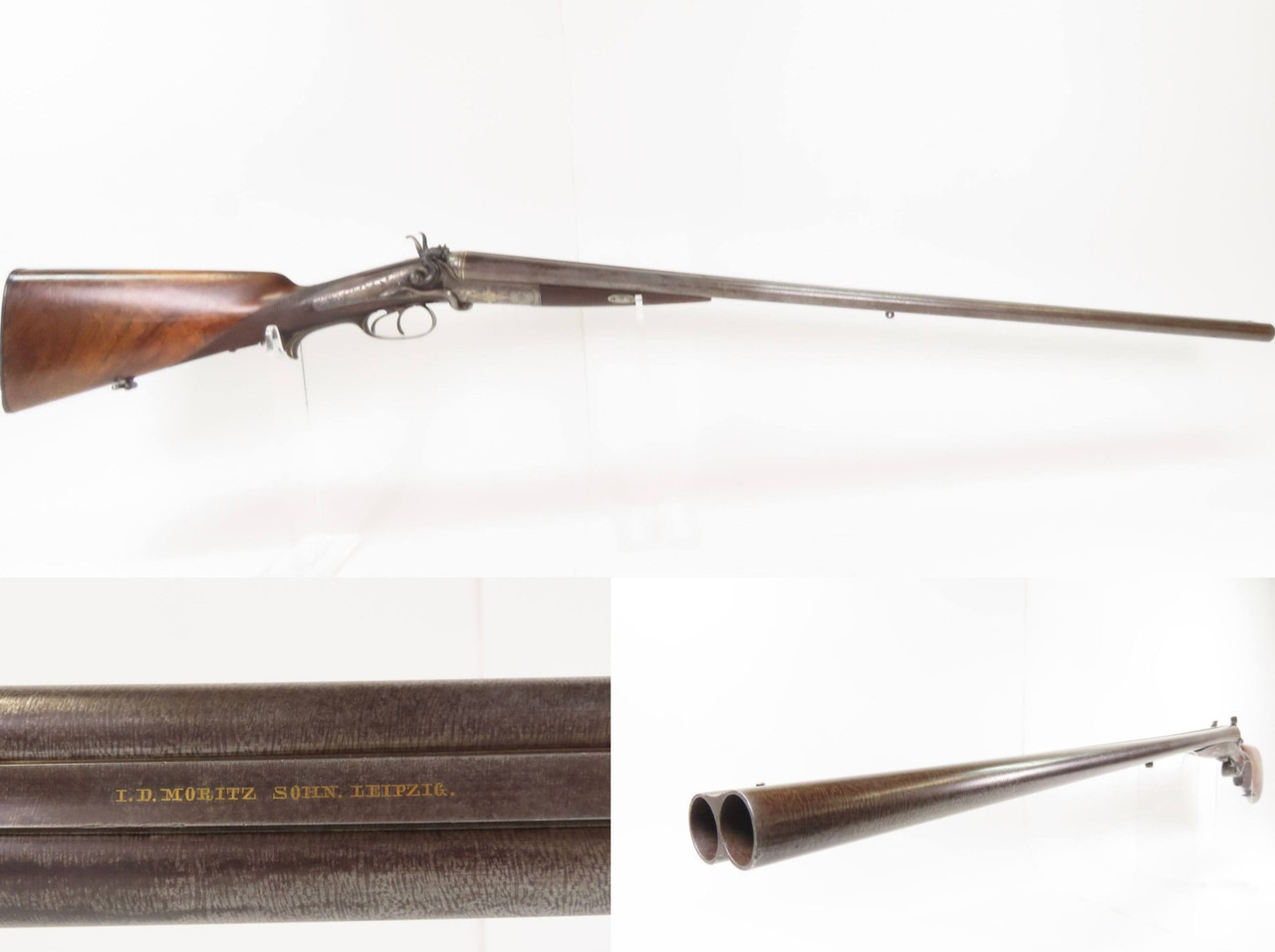

Not mine at least not yet. What type of lockup might this use?

Looks like a Henri Roux of Liége, Belgium design¿

Wasn’t sure if it used a purdey type underbite or something odd. Has a broken hammer spur repair but rest of gun looked nice. A tad bit high priced. Would have been fun to shoot with my french side lever 16. Don’t think I will go the 2200.00 but would have at 1200. Thanks for the input though.

Oh, No green man in the engraving ( all the others with similar engraving on top strap had the infamous guy but not this one.) that would have made it quite a bit more interesting to me.

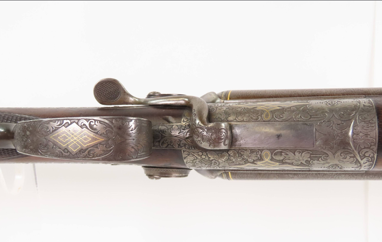

You know, I am not certain @ all but I think that to be a Left-Handed scattergun?

That was my thought.
Edit: I believe I need to correct myself. I had my Jeffrey Rook & Rabbit rifle out yesterday and while it's built on the Daw action, the operating lever is on the right side and quite handy.

I have seen that type of action before. I believe it is right handed. You just push the lever down with the thumb on your right hand, not much different that the top levers. The action lock is not any different than any other top lever gun.

This lock is the same as the common under lever, snap action, lock. The underlever is just formed to the right side. whether the lever is under the trigger guard, on the right side, or left side, the lock works the same.

Nothing special about that action. Very typical. Many times the lever would be on the left side of the action on the English made guns. The long strip on the bottom of the action is the spring for the underlever. These actions usually lock using just one bite on the rear lump. W&C Scott made oodles of these. I restored a Wm. Moore & Co. gun using a very similar action a few years ago. Very simple. Robust. Well made.
