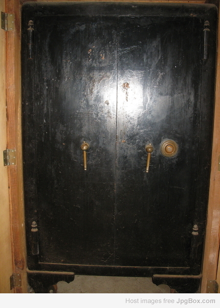

Never worried about humidity. I repurposed an old, big, Mosler safe almost twenty years ago. It was the safe for an automobile dealership near here, originally. I removed the secondary steel doors and the wooden drawers, etc., then carpeted the inside. I then drilled a hole through the floor (about 8-9" thick) to run the cord for the Golden Rod I bought. it lays on the floor of the safe, toward the front, always on. I have had guns in it for all these years with no humidity monitoring. Never one bit of a problem, even though the safe is in a mostly unheated room with a concrete floor.
It stays warm inside without any hint of moisture problems, even though there are times when the outside of the old safe is totally wet with condensation. I've never understood how the warmth inside eliminates, or at least renders harmless, the humidity. I live in a very humid environment.

Humidity and condensation are relative. A golden rod does not remove water. It simply raises the temperature and thereby the amount of water that the air can hold, thus preventing condensation. Exactly the opposite of what a cold beer does on a warm, humid afternoon. Pretty simple chemistry.

Stan,
The problem is not the humidity, per se. The problem is condensation. If you keep the guns in the safe just a bit warmer than ambient air temperature the moisture in the air can’t condensate out on the guns. You get a bonus for having the higher humidity in that the wood is happier at 60% room humidity than it would be at 22%.
Most of the time, it is inconsistent temperature that causes the metal parts to form condensation, and get rusty.
