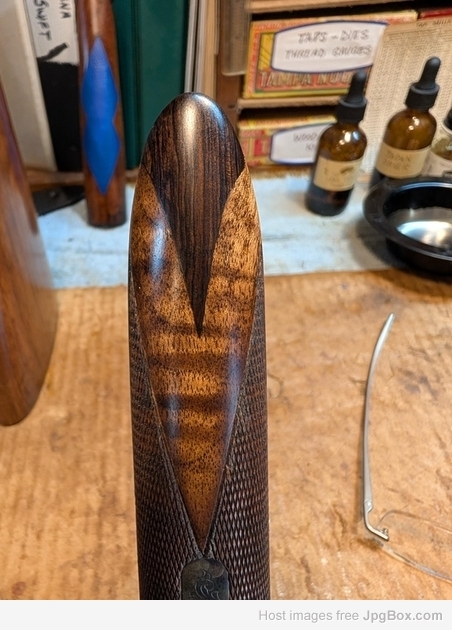

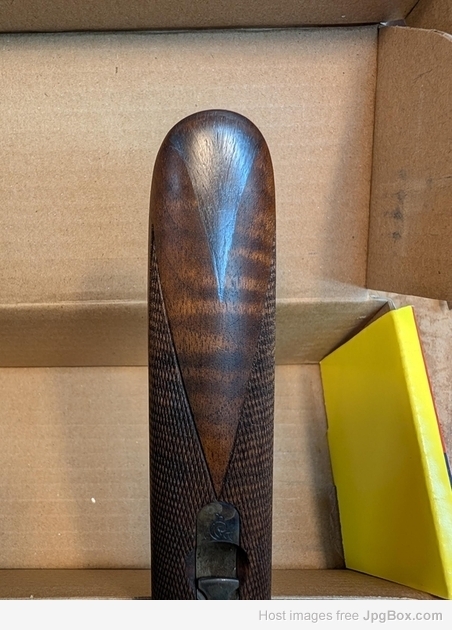

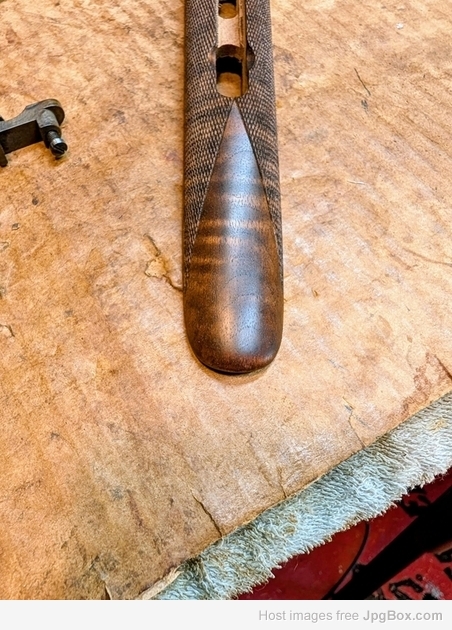

As promised a few weeks ago, I am ready to post pics of the forend inlay that I had done on my Dickinson Estate .410. I've had it back for several weeks but wanted to do a refinish on the wood before posting the pic(s).
I cannot express how pleased I am with the job Mark Larson did for me. He was extremely easy to work with and knocked it out of the park, IMHO. I requested ebony and did not specify jet black ebony (Gaboon?). I'm glad now that I didn't, even though I did have black in mind.
There will be "before" forend pics and an after. I drew roughly what I wanted it to be shaped like on the wood itself with a "lead" pencil, but asked him to use his artistic talents to fine tune the size and shape, and of course, symmetry. Being a Libra, I'm pretty anal about symmetry.

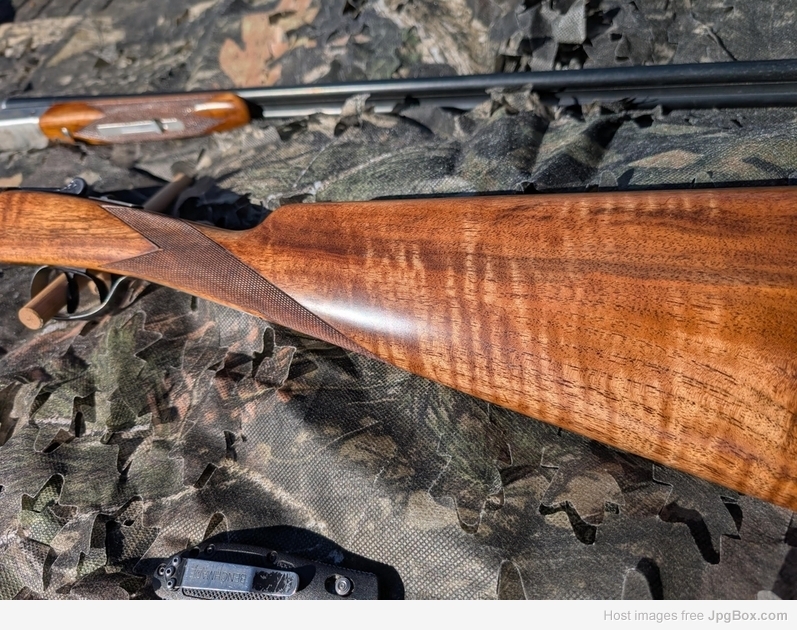

I just finished up the refinish on the wood a couple days ago. It consisted of three applications of the 1:1 Tung Oil and Marine Spar Varnish + mineral spirits + Japan drier sanded in with 320 grit wet-and-dry, one application sanded in with 400, and one with 600. Then, four applications of the 2:1 finish itself diluted with mineral spirits, then softly wiped off with a clean, soft flannel cloth. It bears small resemblance to the wood finish it carried when I bought it new.
Before . . .
After the sketch I did . . .
The finished (pun intended) product . . .
And, the buttstock after the refinish . . .

Beautiful work! The inlay works very well, and the refinish is quite the improvement!

in addition to the ebony inlay it looks like he also reshaped the forend to be more tapered than the original shape and I like the new shape much better. I also really like the color and grain of the inlay.

I very much agree, Bob. I am so glad I sent it to Mark instead of tackling the job myself. His artistic eye and abilities are evident here.
