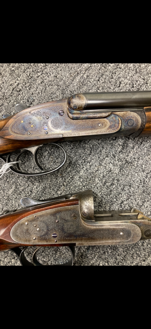

If someone could post a photo for me I can show how a tiny action can be strengthened without adding too much weight or bulk.
Thank you.
Thank you.
Email it to me, I’ll get it up on the board for you.

Ted,
Photo sent. Thank you.
Ted,
PM sent, Richard.

Richards pictures:
[Linked Image from i.ibb.co]
